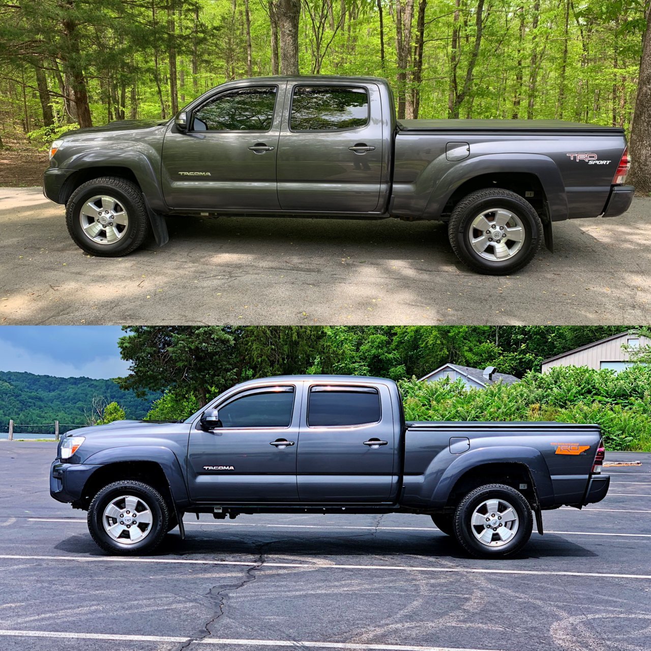

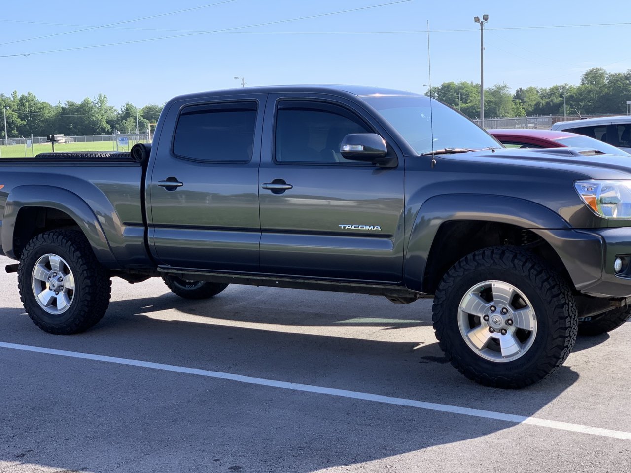

    I've got 5100s Front set at 0, 1/4 driver side spacer for taco lean, 5100 Rears, OME 885, and 1.5" Rear Block. Probably will swap to a new leaf setup at some point, but for now, it does the job fine. After leveling out, got close to 2.5" or so from it. Upgraded tires to 275/70/17 and got a little more lift from that too.
    Before and directly after shot of the lift
    Current look with tires

    BFG KO2 275/70/17

    Just noticed your in Nashville. If your gen 1 needs a new set of tires before turning over to your son, holla at me! lol I've got a set of Michelin ltx at2 that I'm needing to sell that I just took off my truck. Only 3000 miles on them.

    did you not like them, or just wanted a more aggressive look?

    Loved the tire, just looked a little off with the lift. Decided to go larger and aggressive.
