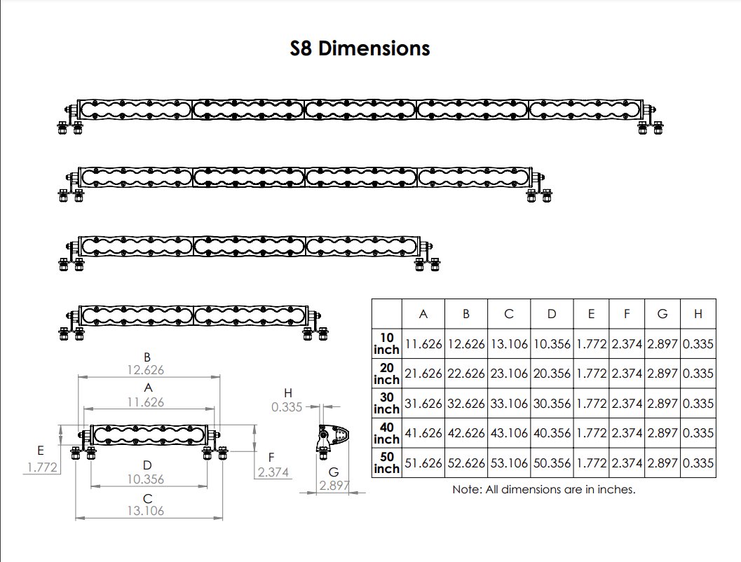

    Hey JBDLB, The S8 30-inch is actually a bit larger than the advertised length so it would fit in this location. If you would Like I can work with you on an order for the light via email.

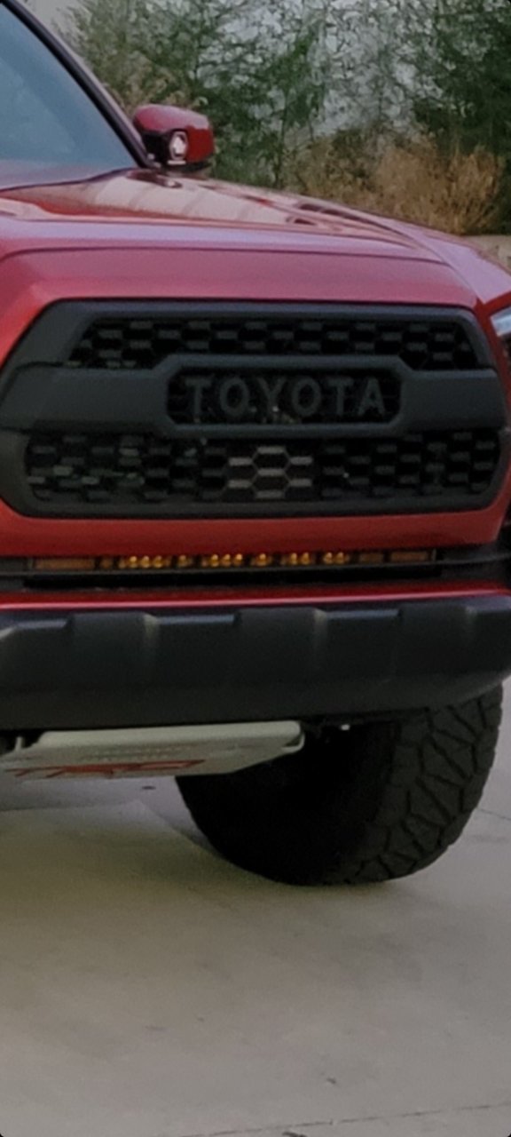

    Hidden light bar? You're referring to this position?
    DD or BD fit perfectly. DD shown here on mine
