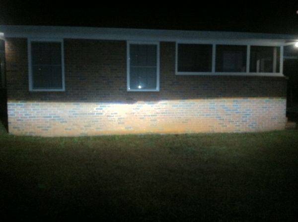

    4300K is indeed the most usable light, I currently have 5000K and there is a bit more blue then I'd prefer. That was my derp for not going with 4300K but they work well enough.
    As previously mentioned to get optimum usability of an HID kit you will need to do a retrofit, Theretrofitsource does sell some quality stuff but it's at a high price... Here's some cheaper projectors that so far have gotten good reviews (just stay away from their HID kit)

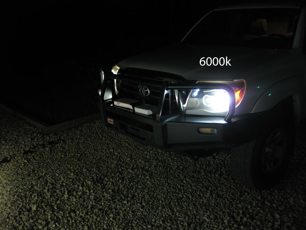

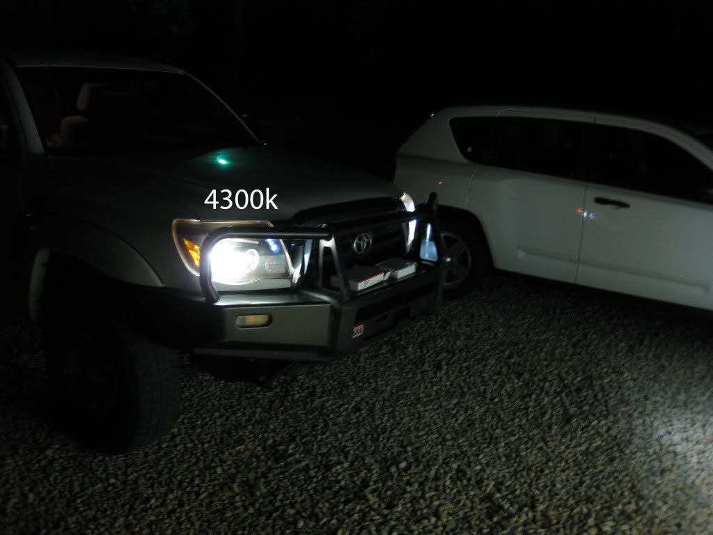

    As everyone has stated for the most part, 4300K is the best,brightest,usable light to me personally. I've got a couple pics of my retrofit setup with 4300K and the output,color,range is spot on perfect, i can see both sides of the road and my fog lights are now useless. a pic
