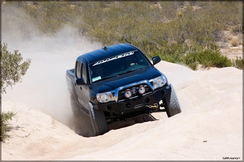

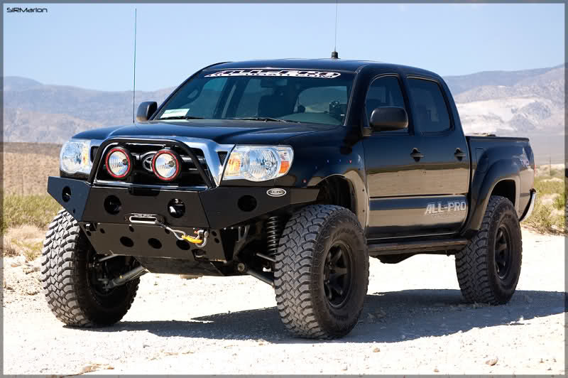

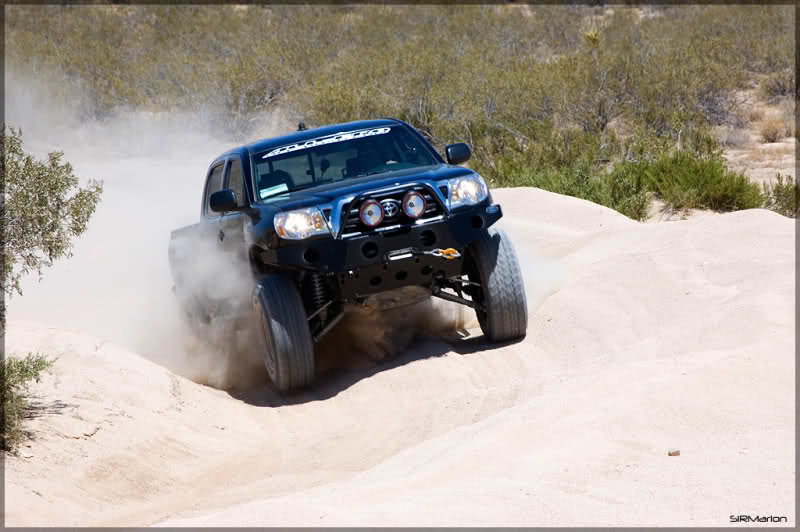

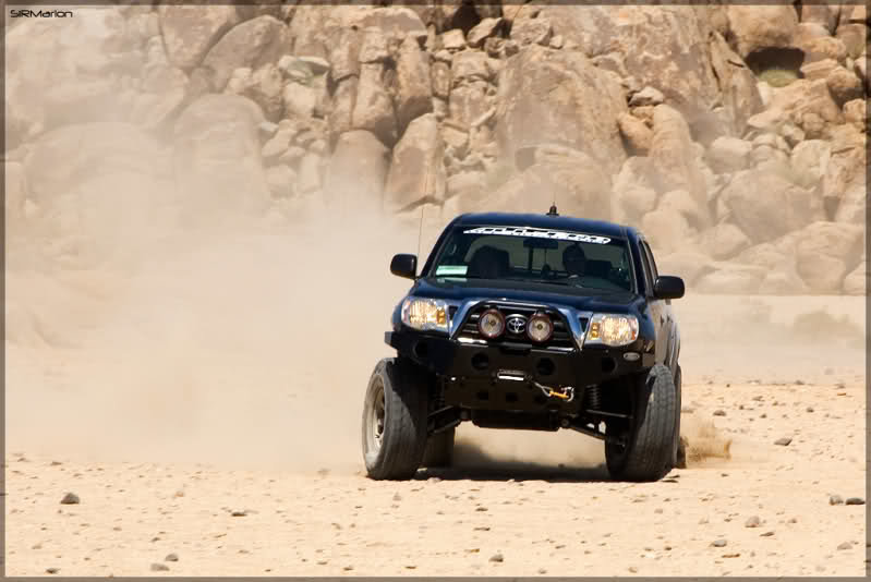

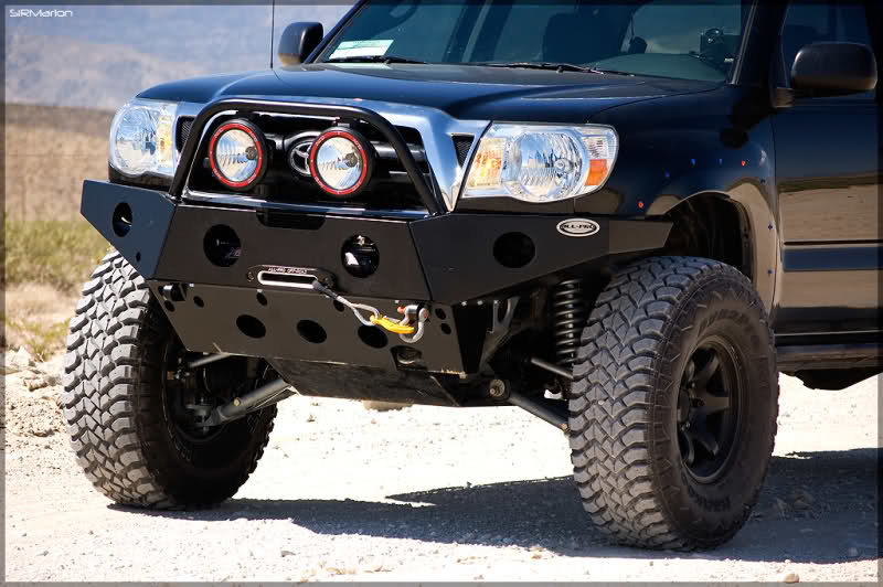

    Mxpatriot, Thanks for all your posts in this thread. I have read all your points and I am inclined to agree with them. The only person on TW that I know of with the AP LT 4x4 kit that I know of is Tom (Monkeyproof).
    I'm not a fan of AP's other products but the 4x4 LT kit seems like the best of both worlds. The fact that we wouldn't have to run fiber fenders is a major selling point for me. I need my truck to look civilized. I need to see this kit on a Tacoma before I buy it... I hear they offer 10% discounts from time to time.
    Have you seen pics of Tom's truck? I found the pics in this thread here: http://www.tacomaworld.com/forum/2n...vs-suspension-lift-post768821.html#post768821
    I also found an install thread that he did here:
    http://www.tacomaworld.com/forum/2n...ravel-install.html?highlight=ground+clearance

    there are a few people that have ap lt. ask Tom how much he paid for his lt(nothing) and see what kind of deals he gets from all pro hense the big sticker on the front window.

    Steve, Who else has the AP LT kit? Anyone on TW that you know of? Why did you quote all the images?
    Yes Tom, frequently promotes their products on TW, and not that it is bad, but I always take it with a grain of salt too.

    lazy, vitang just got his put on, one of Tom's freind has it, his name is Denny but i don't remember his user name. they don't really come on here that often. people can take what i have with a grain of salt, i don't promote anyone and each is their own. people like camburg,chaos,engage or all pro go for it. it's your money.

    ya that's it. must be a good kit:p

    I looked into how Tom got his LT kit. The kit was valued at ($2795) but since he won it it was no cost to him. But I think he had to cough up the cash for the shocks ($1395), extended axle shafts ($495) and the bump stops too ($169). I'm definitely not a fan of the big AP stickers though... I would need to be paid a lot of money annually for that. :laugh:

    people sell awesome stuff on here all the time. I would hardly consider this a valid reason as to why the AP kit is a bad one.
