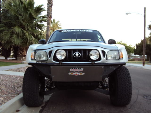

    Chase, did you install your AP LT kit yet? Did you make a build thread? Are you going to run 35" tires? :)
    I read that Currie makes the extended axle shafts. I took comfort in that detail when I learned of that.

    Man 4x4 is a beautiful thing. Nice stuff there. I'd honestly be less freaked out doing whoops compared to all the rocks and tight canyons you did. I just about have a heart attack riding with my buddy on the main divide along Corona, CA.
    I'm curious what second gen can run LT and 35's without fiberglass. I don't think any kits can.
    I'd have to agree with mikesdoublecab, wouldn't you guys want a solid axle front? I think I'm 4" over on each side.

    Crom, yea I did. I'm gonna run 33's as soon as I use up the last few thousan miles on these 31's.
    I have a build thread already up, I will do a full detailed update soon.
