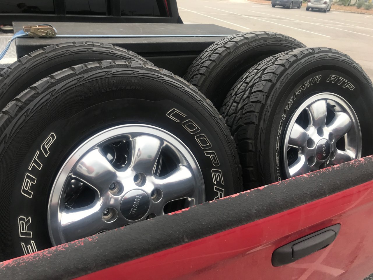

    can someone tell me for sure which lug nuts i need to get for these wheels?
    they came w/o and aren't going on my tacoma.
    they are 250 miles from me, but i'll have them this weekend and would like to get lugnuts by then too. thanksimage1.jpg

    You say they AREN'T going on your Tacoma, then, what vehicle ARE they going on??? It would be hard for someone to answer without knowing that??
    Or, did you mean they ARE going on your Tacoma??

    They’re going on a Colorado which has the same 12x1.5mm lugs, but it uses basic acorn lugnuts.

    The wheels determine the type of lug nut, the vehicle determines the thread. If those are Toyota wheels then you need mag style lugs.

    From what I can tell from the lug bore area, you will need to use conical acorn style lugs.
