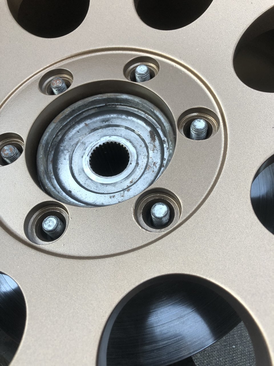

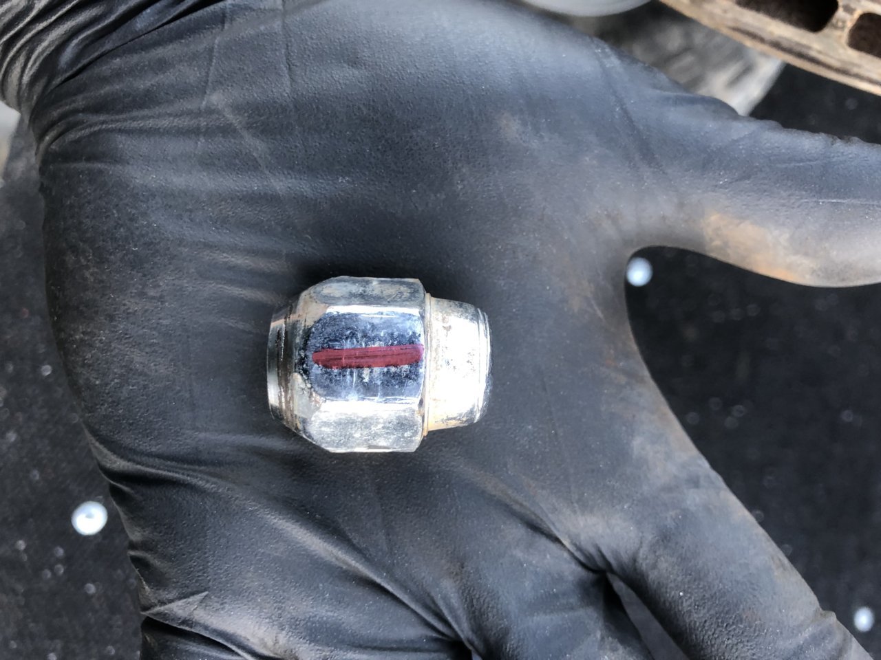

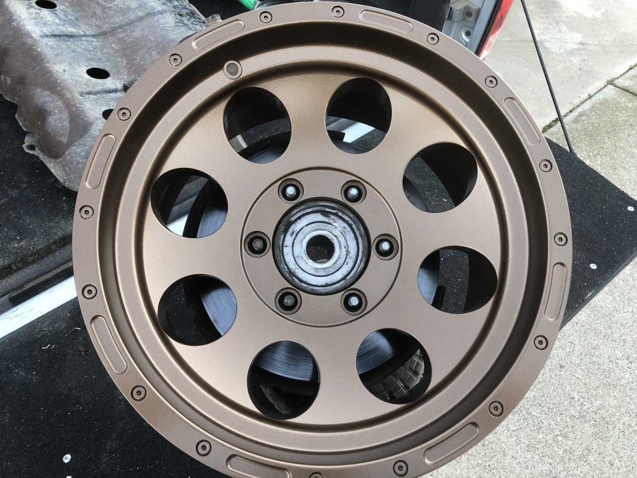

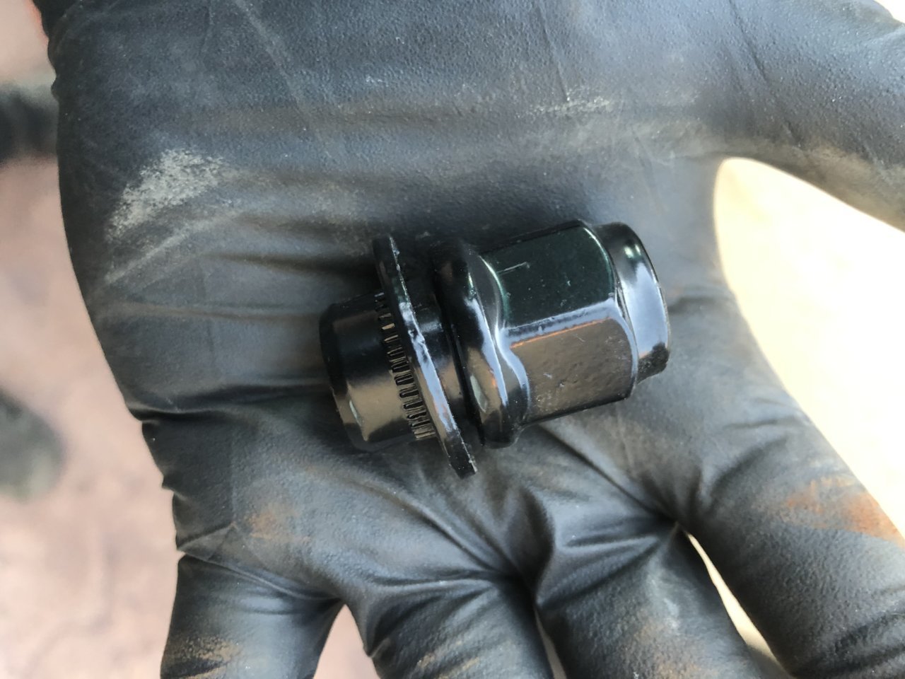

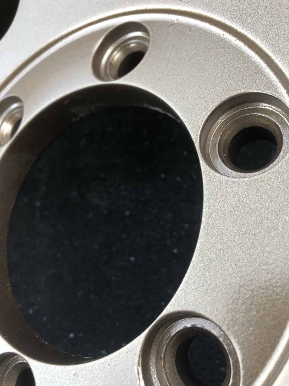

    I recently bought some wheels from another 1st gen owner locally.FE380D94-B078-436A-96DE-0A65B57C269F.jpg The problem I have is that I do not know which lug nuts to use(did not think to ask the PO) I am currently running acorn style on my steel wheels. the new alloy wheels are much thicker but I am able to get atleast 5 FULL turns before I torque them down.636E9846-AACC-4E76-916B-24F7BD7BB8D6.jpg D5E842FE-1D06-4AB1-A586-9B8C1FE1043A.jpg Just wondering if that is enough thread engagement to be safe. The stock mag style lugs to not fit the wheel lug holes. FA12F30B-9A19-4EBE-819C-F81BE5364A0F.jpg 209C7C42-4D4B-45E3-8CCF-FAF7558C0004.jpg

    The black ones do not fit in the holes in the wheels. They fit in my fathers stock alloys as thats where I got them from.

    Your wheels look like they have a slanted edge to accept a lug nut (are they pro comp? look very similar to mine), you will need an ACORN style lug nut. The one I linked is what I have been using for 8+ years now. They work great for wheels with thick hubs.
