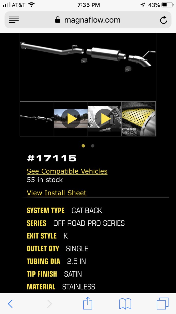

    Anyone running a Magnaflow 17115 muffler with the stock tailpipe? I bought this system and had it on for a week but the drone was too much. I’m thinking of putting the muffler back on but running the tailpipe out the stock location.

    Sorry bro. What did you expect to get with a straight through set up.
    Sorry bro but if this is what you bought what did you expect with this kinda of design873E2C4C-7812-4314-9C0B-085605E36EF5.jpg
    It says off road. Most ppl don’t care about drone off roading. I love my magnaflow setup. I posted pics , info and video sound clips. No drone. Perfect lower toned growl. Not obnoxious flow master tin sound.
