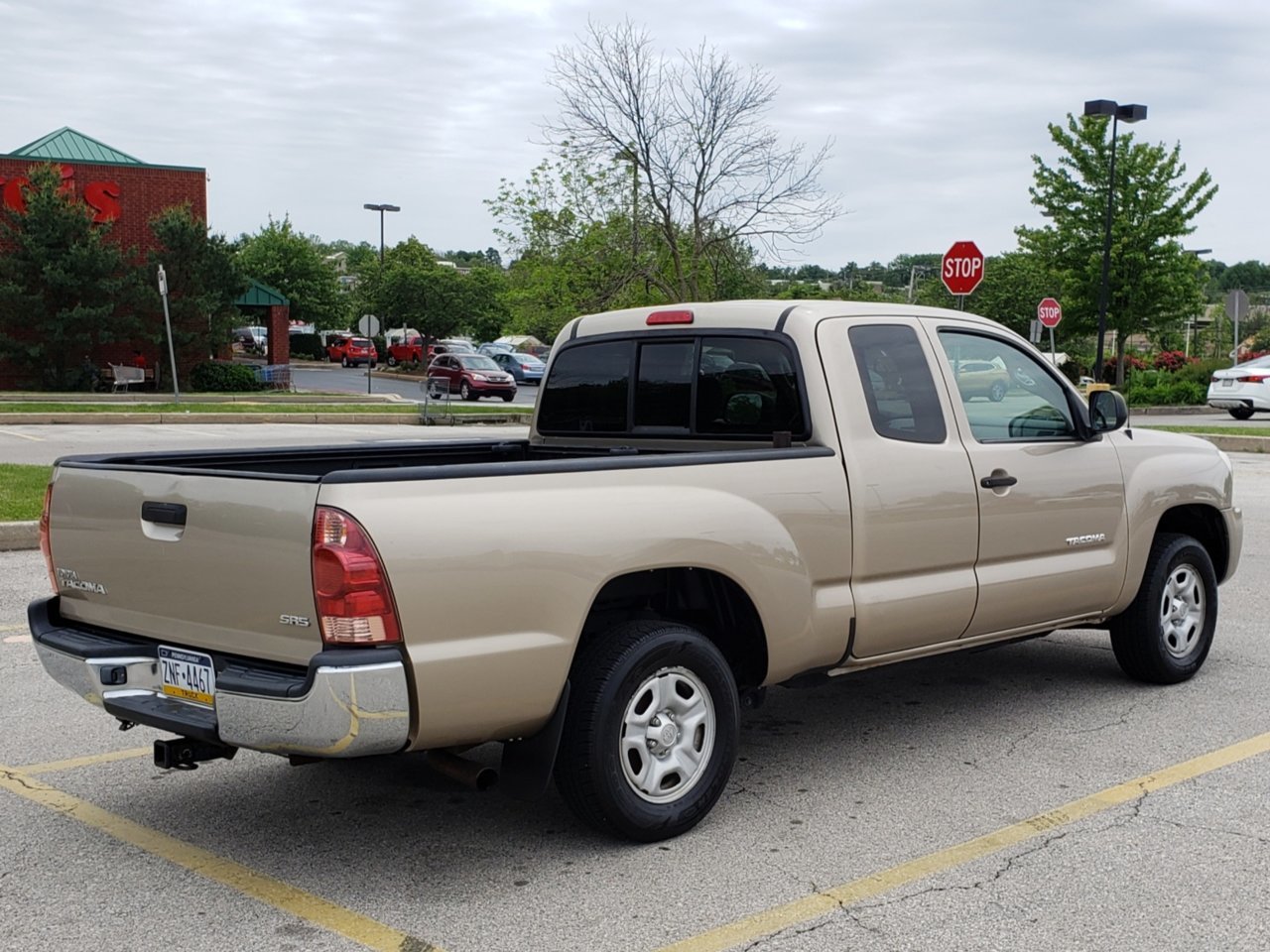

    2006 Tacoma
    I purchased a 2006 Tacoma. Runs great. Clean. Highway miles. As I am looking for mods, I'm always asked what model it is, such as base, pre runner, and another one I forget. Nothing on my paperwork indicates a model. It is a gold access cab, 2wd. It says SR5 on the tail gate. Any ideas guys? I attached a pic.
    I'm new to the Tacoma. I have to fix a couple things like fog light not working, cruise control not working but dash light goes on, and the tire inflation light is always on, even though I'm at proper inflation.
    Need some help with these issues if you have any insight. Thanks!

    Looks like an SR5 to me. The tailgate is correct. Looks base as well.

    If you load the vin into Toyota site you can get details.

    Take your VIN and see what it tells you.

    it's a base with the sr5 package. the sr5 package gets your cruise, power windows, locks, intermittent wipers, upgraded seats, sliding rear window, color matched bumpers
    your pressure light is likely flashing because it's very likely the batteries in the sensors are dead. you can replace the sensors, let it flash, tape over it, or disconnect the receiver which is located under the roof liner back driver side.
    i don't have an answer on the cruise. could be the spiral cable (was a recall, worth checking out), could be a bad unit, could be something else.
    also, open a toyota owners account, punch in your vid and see any open recalls and any dealer performed service
