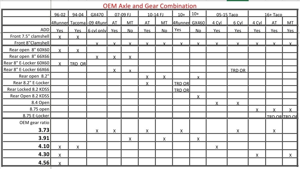

    Hey Jeff,
    Mind if I ask how you sourced this info? It seems there's some conflicting info out there, as this chart shows the L4 to use the 8.75/8.8" rear diff.
    For context, I'm currently trying to investigate the capability to use the L4 6AT 4.30 rear diff gears/housing with an aftermarket LSD/locking carrier in my V8 T4R, and the L4 6AT 4.30 seems like it could be the answer for a simpler job by simply swapping the carrier and pinion flange to T4R parts, but I want to investigate any info discrepancies before buying parts.

    That chart is bunk.
    My information is from the Toyota parts catalog and New Car Features books.
    Only the manual transmission and/or locker rear diffs are 8.8” on the 2016-2023 Tacoma. All others are 8.0”.
    Jeff
