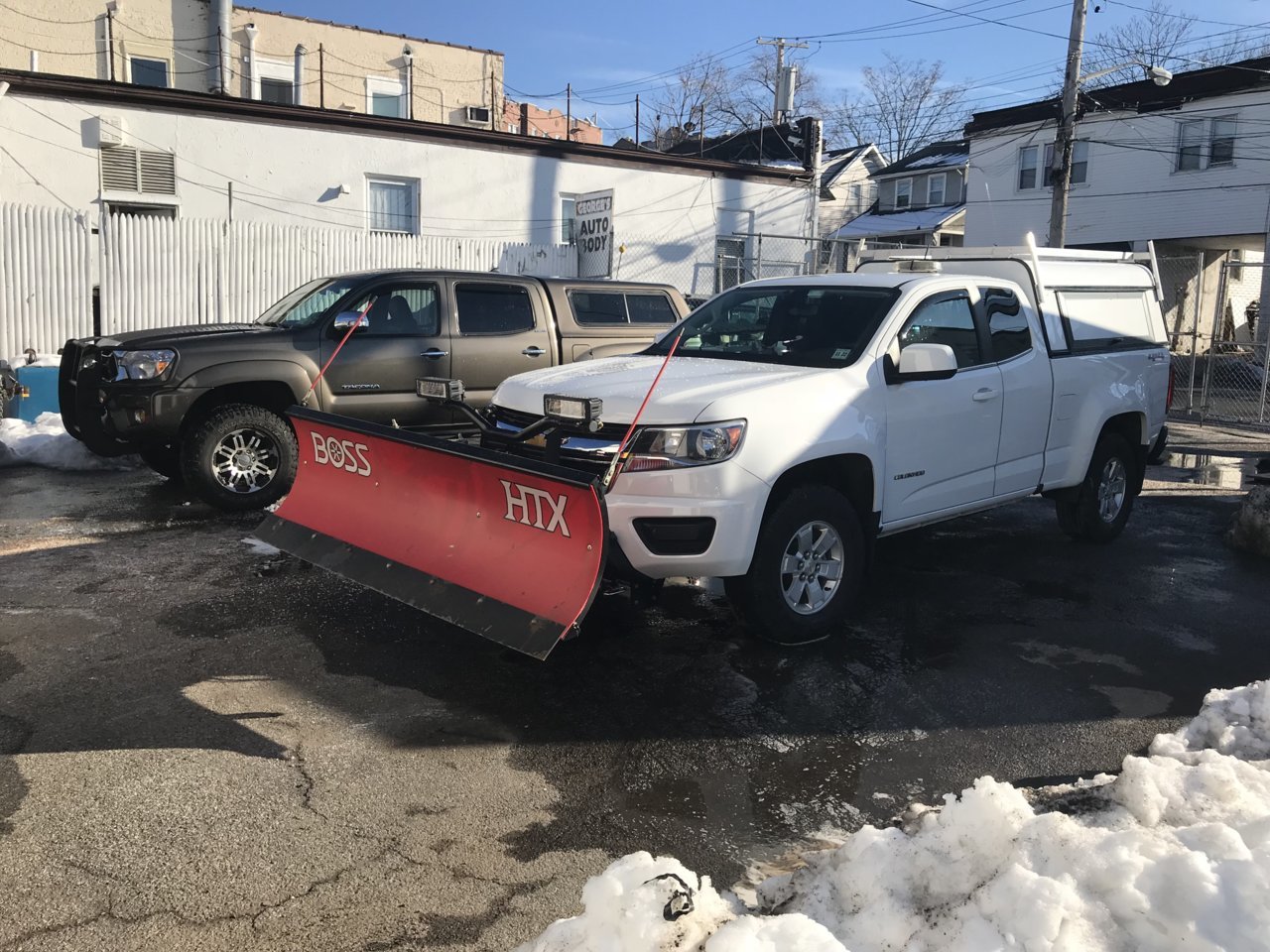

    western and boss makes non commercial plows i have used them on a jeep wrangler 2 door stock suspension, and chevy 2010,2012, and now 2017 colorado's all company work trucks the 2010 and 2012 stock suspension the 2017 had to put a leveling kit on front was too low.

    Thanks for the feedback and pics, appreciated.
