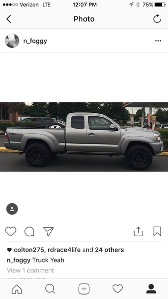

    Another thing I should mention too is the loss of low end power when you bump up to a 33" tire. I'm running stock gearing right now and it sucks. You have to drive like a maniac to get the sluggish feeling to subside. That's a spendy upgrade. He's my old rig for ya with stock everything other than the wheels and tires

    It seems everyone has different experiences with similar set ups. I can say for me personally, when I did BP-51 kit with LR UCA's, F5's that were 8" wide w/ 4.50"bs and +0 offset on 286/75/16 trail grapplers, it fit without rubbing. But if you plan on running that size of tire, you're going to want to re gear or you'll hate driving your truck. My feels so gutless. I'm working on getting it re gear when I get a break from the chaos at work. Im new to tacomas, and there are people way more qualified than me to speak on the subject. I did a ton of research and trial and error to get my truck where I like it

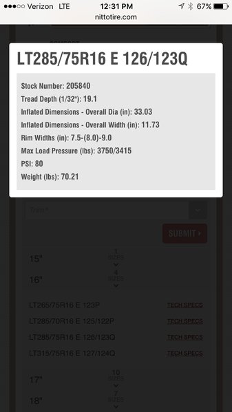

    What was the width of that 33" tire? Mine would only be a 255/85 if I went 33's. It'd barely be a 33 and it'd also be a pizza cutter because of the 255 part which would make the tire 10" wide. This would help with weight.

    Yeah that's what I thought, it is wider than a 255/85 so they're gonna be heavier. Maybe you lost some low end because of the tread pattern? Where you running street tires before?

    I lifted this one before I ever drove it stock. But being a wider taller tire is definitely the reason. If you like the pizza cutter look, try that set up and see how you like it. If you have to re gear, so what. It's only money
