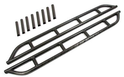

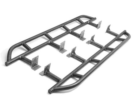

    I'm assuming these just get welded to the frame with the pre cut tube pieces?? Should I get "L" brackets to weld to the frame for strength? tgi-120003-1-kit.jpg
    Or would this kit below be better? Says bolt on but TG recommends welding them on.
    There's about a $70 difference between the two kits. Of course the bolt on is higher in price.

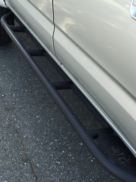

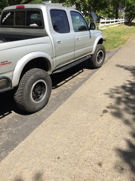

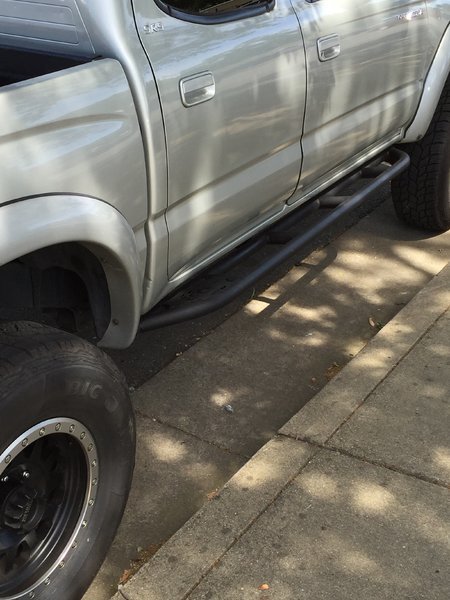

    I bought the bolt on TG sliders and had them welded on. Didn't need 32 holes drilled into the frame. They're very sturdy and have the plates and gussets already there. Makes welding much easier. With the weld on ones they might be cheaper but you have to buy the gussets separately. So it adds up.

    Looks awesome! Thx for the input. Did the bolt on ones come fully welded? Meaning all you did was weld the "L" bracket ends to the frame? Or are the legs detached so you can pick the angle you want the sliders? Confusing cause the pic has everything welded.

    I was trying to find some pictures of the L brackets welded to the frame. I can get some pictures in the morning. But yeah, I had them welded onto the frame just the way they look in your original post. They come fully welded. I just picked them up from 4wheelparts in Sacramento and headed over to Califabrication in Carmichael to have them primed, painted and welded on. I'm glad the sliders are rattle canned since I'm constantly touching them up. I had my front TG low pro bumper Line X'd. And it's held up great too. I primed & rattle canned my rear TG bumper also.

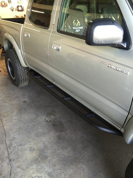

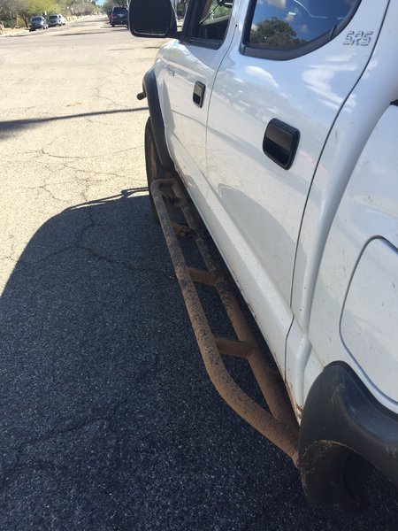

    Here are mine, I bought the diy ones and had them welded on. Painted with self etching primer then rattlecan trickbed liner and love em. Could have been tucked in a little more but still happy with them.
    Sorry they are a little dirty...

    Got anymore pics of the truck?! I live in Tucson too! Were the L brackets welded all the way around or just a little on each side?

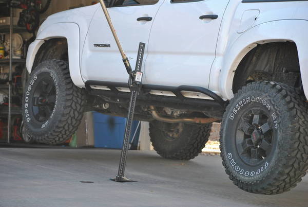

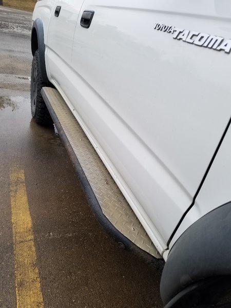

    Weld on TGs with my own design aluminum diamond plate 'splash guard' which helps keep the doors clean(er) of road spray and my gravel road mud.

    Mine were the TG un-welded kit too - I did all the necessary welding and liked that I could choose how they stuck out and what angle they sat.
    This takes some time but I am happy with the finished product. I lifted up the side of the truck with a hi-lift too. (can't find the pics though)
    BTW - I have installed these TG sliders on my truck, my brother's '08 DBL Cab and my cousin's '00 extended cab - all with good results!

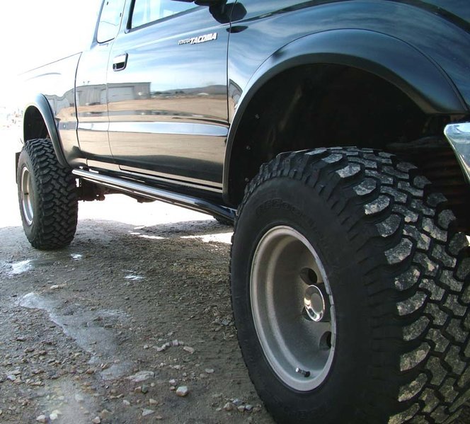

    Like this??? Not the trail gear sliders but still pretty cool!
