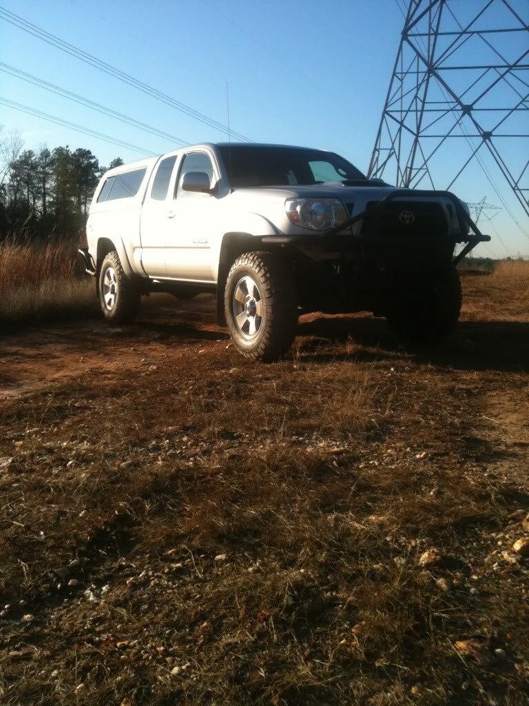

    Im running stock coils on 5100's set at 2.5, i have a badland baja bumper with no winch yet, would the 885's be a better coil option for me? i dont like that i have to preload the stock coils, but i like the look it gives me, and clears my 255/80's. would the 885's give me the same amount of lift, and possibly a better ride????

    They should be pretty damn close to the same amount of lift and ride better because you won't have nearly as much preload on the coils (the coils will also last longer because they won't be as preloaded). How much does the Badland bumper weigh (I'm assuming it's relatively light because it's listed as a 'Baja bumper')?

    I am assuming it weighs about 100 pounds without a winch, i plan on putting a winch in later down the road. Thanks for the quick reply, there are so many different options and combinations out there.

    sorry for the picture quality, but this is my ride. as you can see the bumper isnt too awful heavy.
