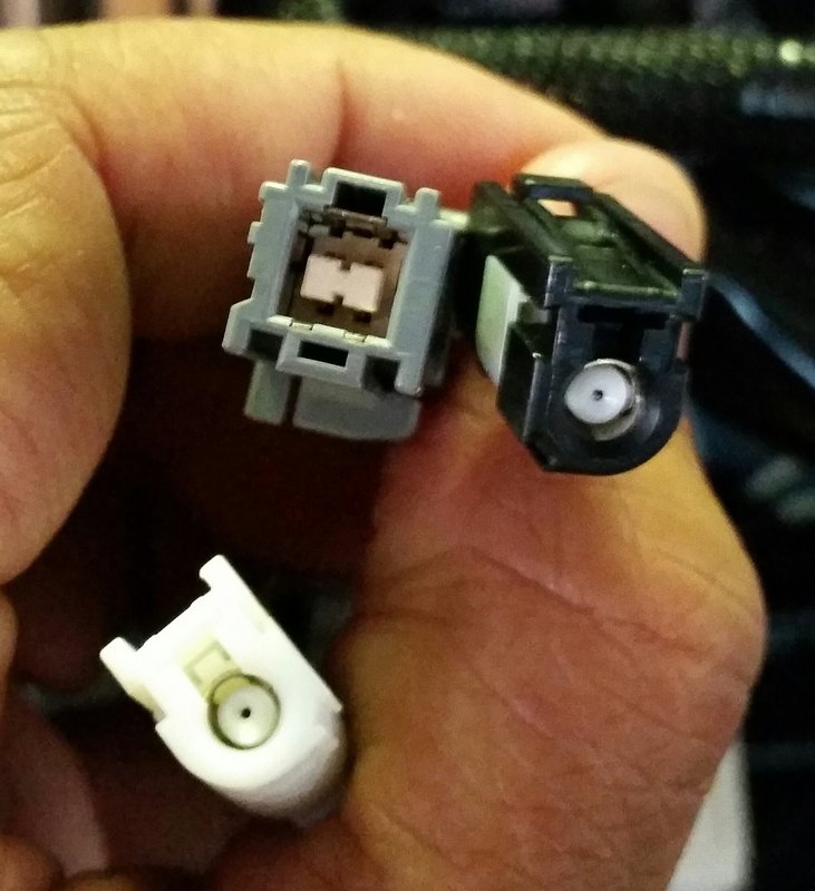

    Anyone know which is to the shark fin antenna?
    And what adapter do I need to connect my Sirius XM tuner?
    I bought the SFA12F cable but that does not fit these.

    The Black one is the XM Shark Fin antenna. The White one is the AM/FM antenna and I am not sure what the Grey one is.....maybe nav?

    I think the white one is the Sat/Nav. I have a 2015 and the antenna that came with my nav unit is white.

    Thanks! You are correct sir.
    Grey i believe is for the USB/AUX.
    White I think is GPS for the "traffic".

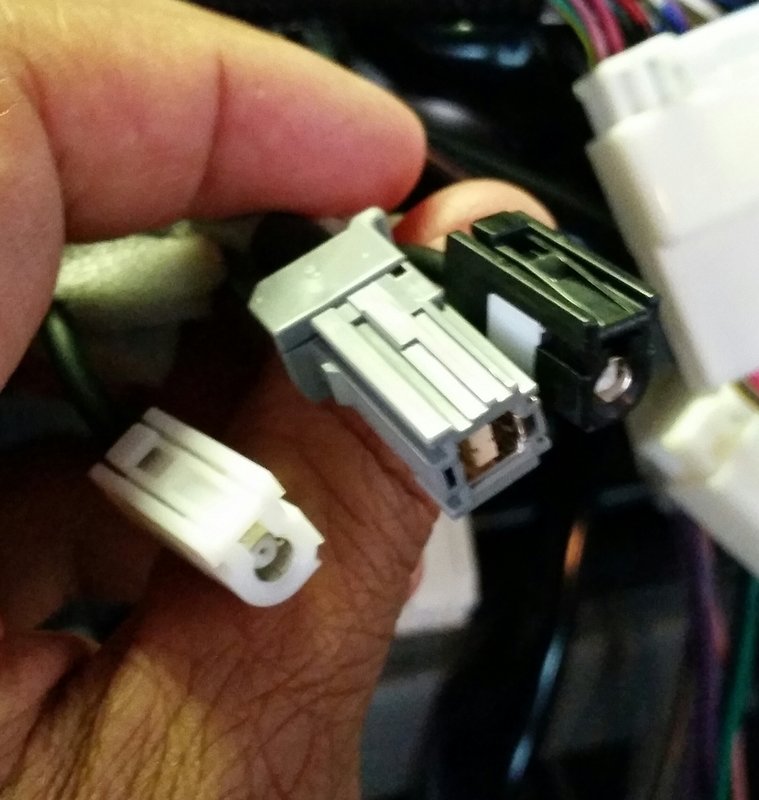

    Same kind of question here. Which one of these connectors is for my shark fin. I have a '12 Tacoma and installing a 14 non nav headunit and need to know what adapter.

    Do you know which of the pictured connectors is the XM?

    It's the black one, the white is the GPS Antenna for your Trafic and Weather stuff.
    Thankfully on the back of the units the corresponding color coded female end is there.
    Now it's called something funny and I forgot, give me a second and I'll find the name.
    Pretty much the funny name is a standard name but the different colors are what distinguishes them apart. They come in about 8-9 different variants but the color is the defining part.
    Found it! They are FAKRA connectors. Do a Google image search for them and you'll see the connector types and colors. I'm not 100% convinced they are them but it makes sense with the color coming in the plugs versus what is on the back of the unit, since I found my solution I didn't dive in any deeper.

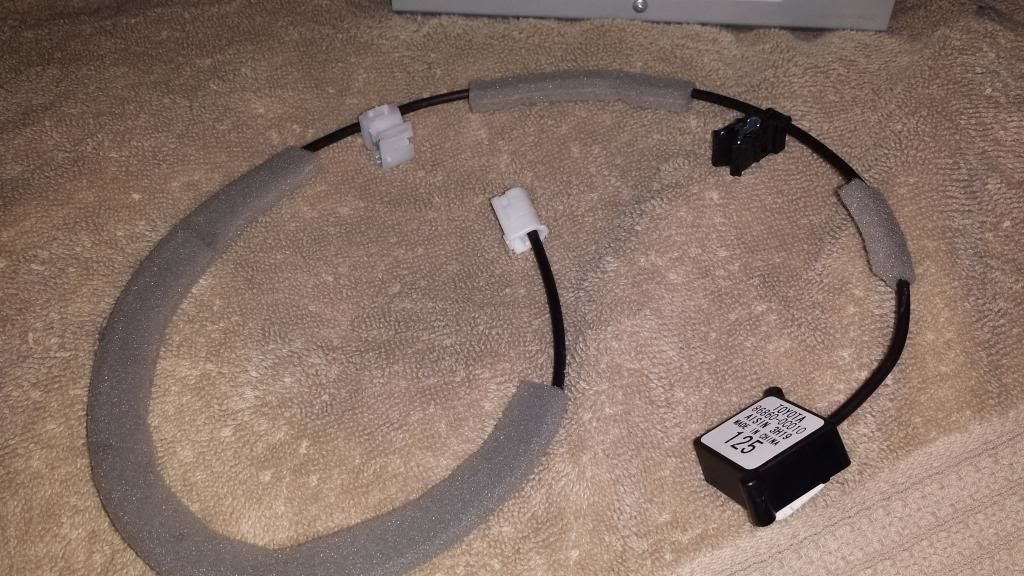

    Interesting thread.... I am struggling with installing a 2015 Entune HU in a 2012. The XM antenna connection is giving me a real fit. I need a connection exactly like the black connector, except the 2012 sat antenna is square with a square connector inside. There's no way to 'make' it fit. Def requires a adaptor or a new fin.
