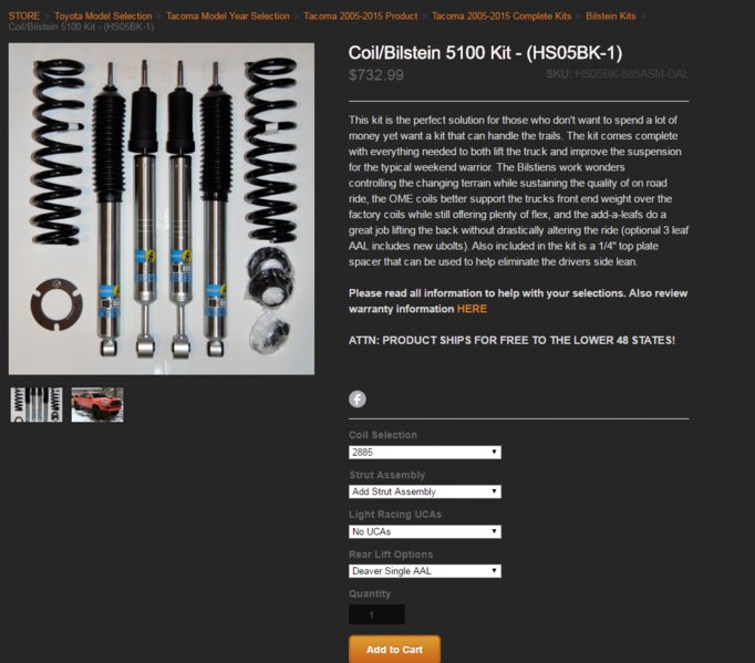

    I'd like to get the most lift without getting new UCAs.. I don't off road but I'm wanting too... I don't have the money for all of it so what would be the best patch for now? I'd like to add to it later if possible

    How many miles on the truck? Are your stock shocks fine? Are you doing the install or paying a shop?
    2.5 is about as good as it sill get with stock ucas if you want a near perfect alignment. 3 is fine but alignment wont be perfect.

    Time for some new shocks. Get the shock kit and an add a leaf, thatll be just over 400.

    At 75K you'll want to replace the shocks too. I know this is over the $400 budget you set but the front assembly will come pre-built which saves labor cost (unless you have a spring compressor)
    * This is with the 885 springs selected which yield ~2.5" of lift *
    http://www.headstrongoffroad.com/store/p440/Coil/Bilstein_5100_Kit_-_(HS05BK-1).html

    If your factory coil springs are in good shape you could get away with just the front bilstein 5100's, use the top notch on them with factory springs to yield 2.5" of lift. I ran like that for a long time without issue on stock UCAs. No lift in the rear will give you a little reverse rake.

    Understood, go for the shock kit then and an add a leaf if you can swing it. That will give a level 2.5 inch lift.
    All youd need to add later are front springs for a less squishy ride.

    ^ That would be my vote too. You'll have a little more height in the front, a little "cali lean", but you'll have quality parts and not mess up your truck by installing cheap junk parts.

    And that would be fine without new UCAs?

    Fine as in within acceptible numbers for your alignment, but not perfect. Im on 3 inches with stock UCAs, my alignment is fine.

    This is what I plan on ordering tomorrow from headstrong! I'd like to go 885 but I can't afford new UCAs... you guys like the setup?
    OME 884
    HS 1/4" top plate spacer
    Bilstein 5100 adj struts
    5100 standard rear shocks
    Deaver single leaf add-a-leaf w/ center pins
    Strut and coil assembly
    w/ free shipping to lower 48 States
    Total = $732.99
