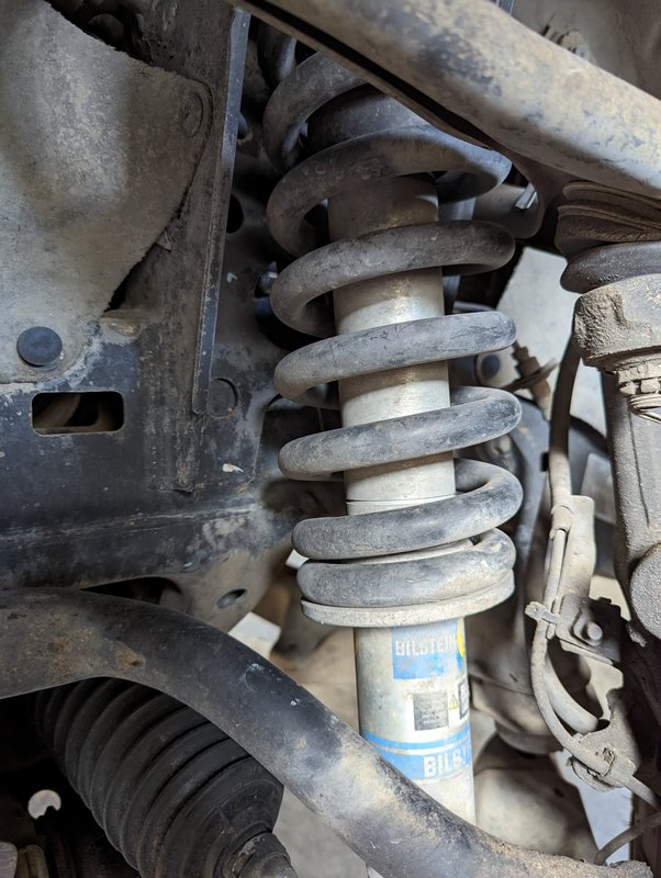

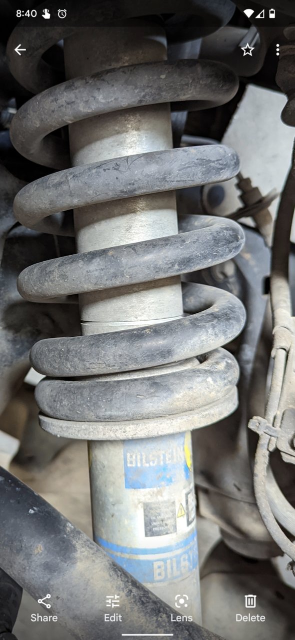

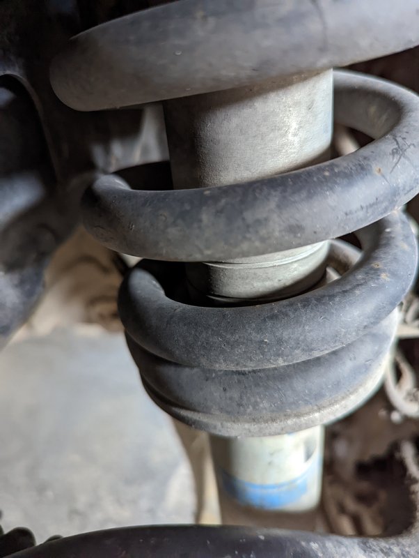

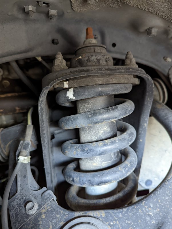

    Look at your shocks, what ring are the springs set at? If you can't tell, post a pic.

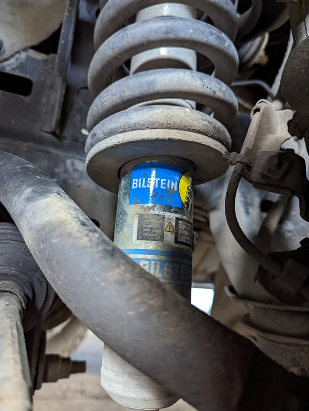

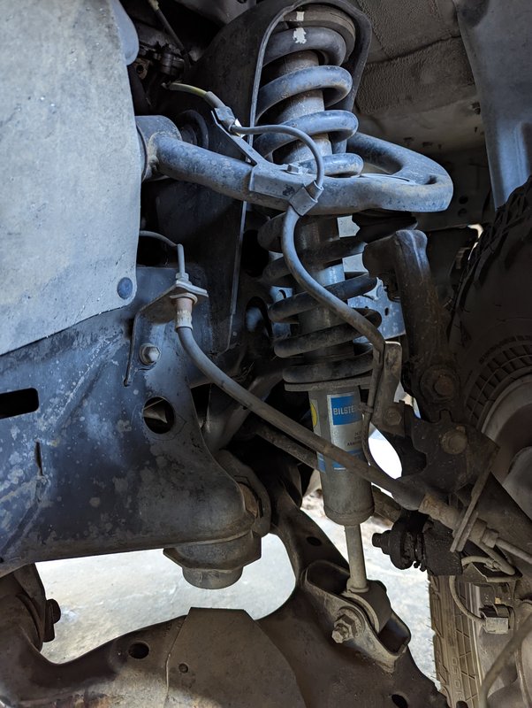

    [​IMG] [​IMG] [​IMG] [​IMG] [​IMG]
    I can see 2 slits above/inside the spring

    I'm guessing the perch/clip is set on the .85" setting.
    Which seems to add up.
    Stock similar trucks are at 20.5" hub/fender stock height (I never measured mine prior to lifting). 885 coils get them up to about 22.5 - 23.0". Throw in .85" from the 5100 and it should sit at about 23.35 - 23.85" or so.

    What's limiting the droop, UCA/ball joint or the shock?

    I don't know for certain. Both the UCA/ball joint and the shock are close to their limit. I don't know which is "topping out" first though.

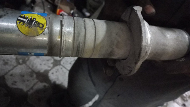

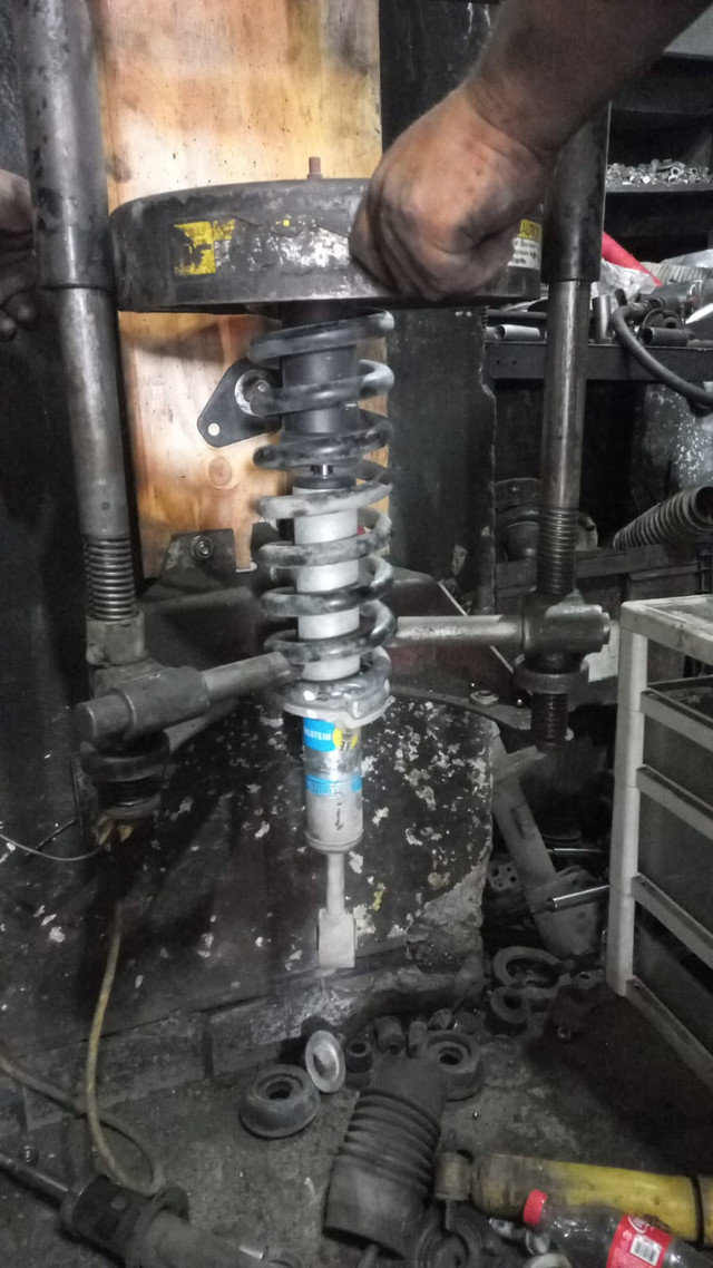

    Ok, update sort of...
    Took the truck to a shop to take apart the strut assemblies to bring the clip down to 0. To my surprise, the clip is already at the 0 lowest setting. How in the world am I at approx 4" lift with just OME 885 coils?

    Just reading through this thread, and looking at the pictures you posted you are definitely at the 0 setting. My guess is the coils you have are not 885s, did you purchase them new or used from someone else? Look at this picture of a 5100 with 885 coils. There seems to be 1 more ring on the 885 (9) then what you currently have (8). Its hard to tell from strictly pictures but your coil looks a little thicker too.
    If I were you I would order a set of 887s with JBAs. Won't cost you much more then $700 and IMO they ride GREAT. It will get you close to the lift you want without the harshness. If you want more you can always use a 1/2 spacer with some extended bumpstops and the ride shouldn't change too much.

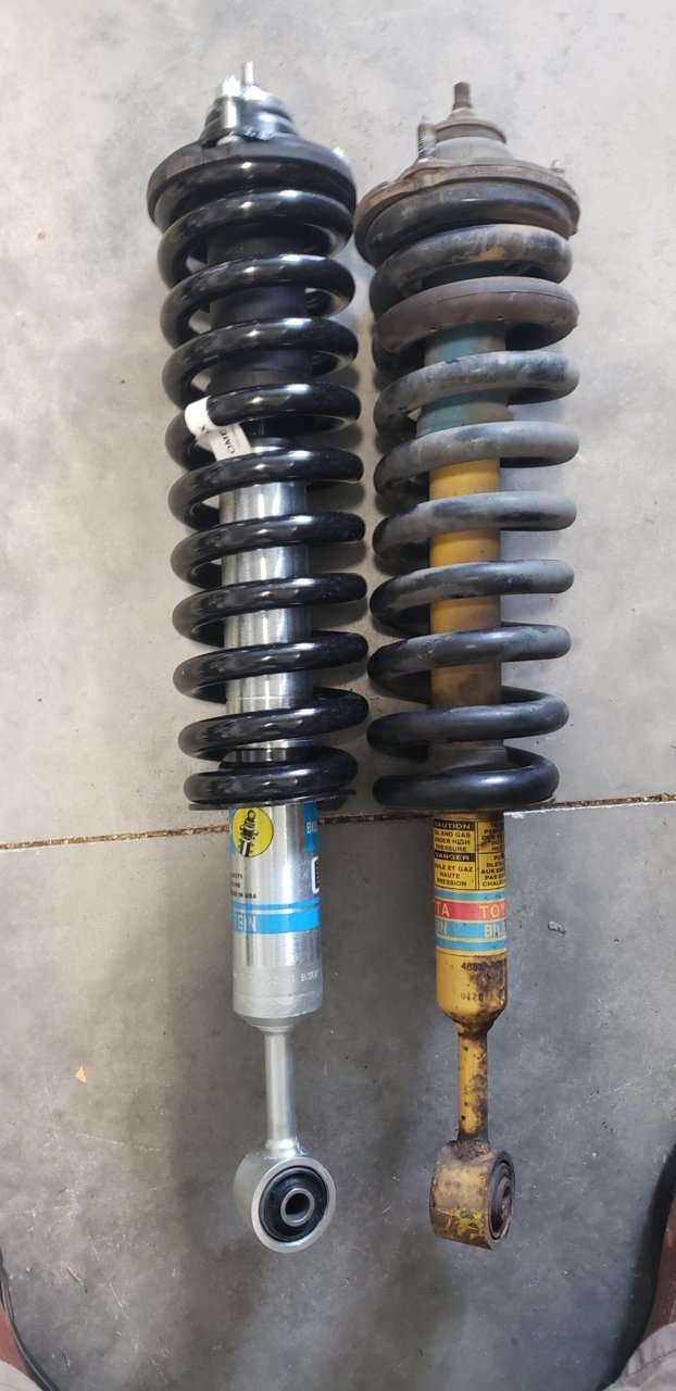

    I've been thinking trying to figure this out and the only other thing that occurred to me is that maybe these perches my strut has is "shorter" and thus has the coil sit higher up on the shock. All the other pictures I can find of 5100s seem to have a black perch and they appear to be deeper, thereby allowing the coil to sit lower in the length of the shock, if that makes sense.
    The 885 coils I bought brand new back in 2010. I paired it with a set of 5100s at that time and this 5100 set is my 2nd or 3rd set (can't recall). The truck seemed taller and felt rougher after this last set of 5100 was installed.
    Either the shop swapped my 885 coils for someone else's coils or this perch is the culprit

    Your bottom bracket/coil bucket or whatever its called looks really odd as well. It should flip down and the spring should seat inside it if that makes sense. Yours looks a little thick, you can see this if you compare yours to the photo I posted.

    Yeah, that's what I've noticed too. It looks different than other perches I've seen online. It's definitely sitting in the right direction though.
