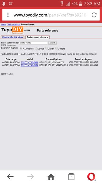

    Does anyone know what door handles, besides the Tacoma, fit the 1999 models ?

    Find the part number in here, toyodiy.com, and then use the reverse search function with that part number and it'll show all Toyotas that use that part number.

    Here's the screenshot of when I did this just now.

    So the answer to your question would be only Tacoma's handle fits Tacoma.
