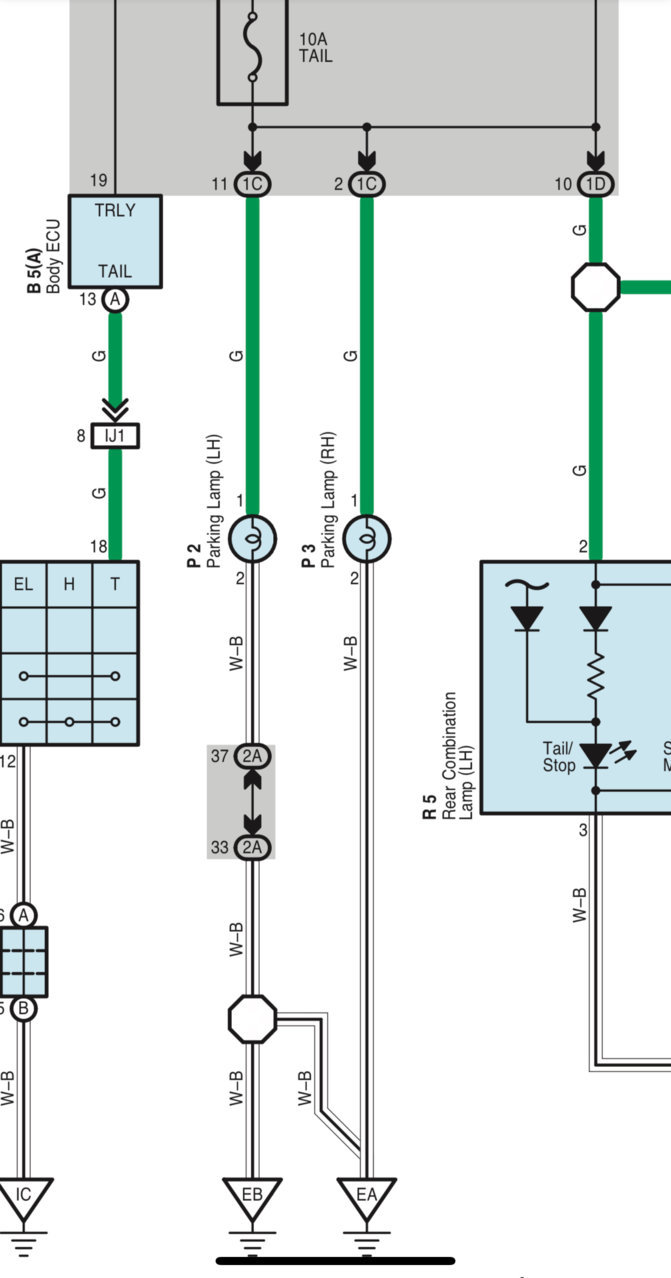

    Use the green wire for positive trigger

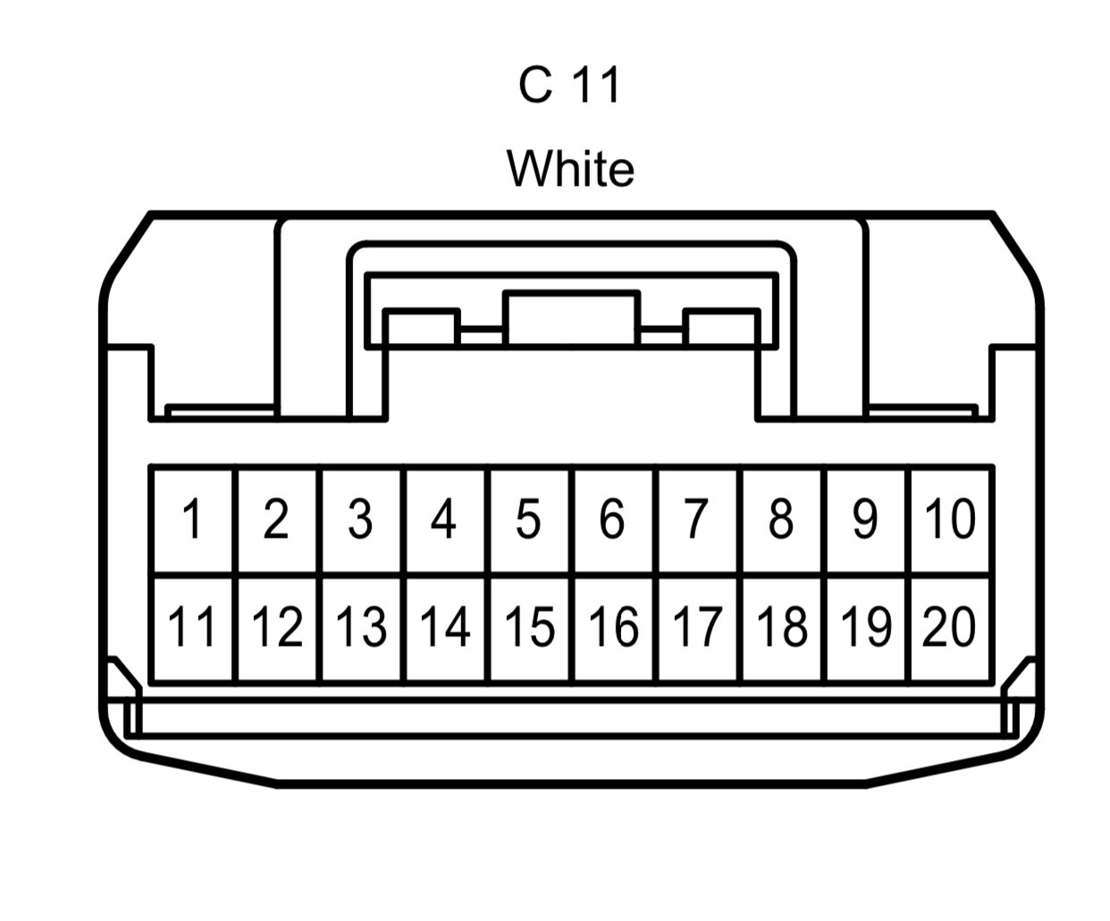

    OK. Is that the green wire on the switch or fuse box? I then need to change the jumper to positive?

    pin 18 of the switch connector. Don’t use the light green that’s for the turn signal. Not sure on your jumper I’m not familiar with what you have there buddy.
