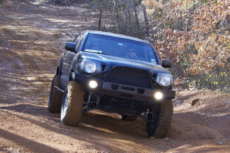

    Any chance you could shoot me a quote on lead time and total cost for the bumper above and the standard rear bumper shipped to 84015? That's in the mountain time zone if that helps.
    And just out of curiosity, how high up does the front hoop come up? Just level with the hood, or slightly higher? Is it visible while driving? And if it does come up higher, would it be possible to make it so that it is just as high as the top of the grille? And do the side supports affect light output at all? It doesn't look like they go in front of the headlight much but it is hard to tell.
    Sorry, that ended up being more questions than I had intended.
    EDIT: May have just found the answer to some of those questions. Which leads me to more.
    This is one of yours is it not?
    Looks like it comes up just about level with the top of the hood. Any chance the hoop could be made to follow the inside edge of the grille?
    Something like this:

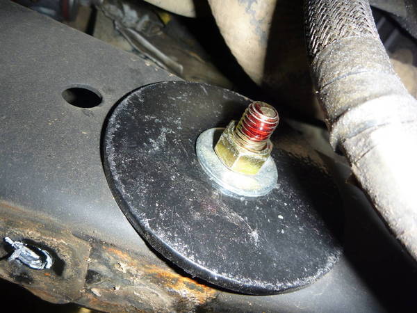

    who ever you choose make sure they brace it properly so if you ever do need to use your winch or get tugged out this doesn't happen to you
    as far as I know Relentless, Elite, and ARB are the only companies that have substantial bracing in the front that I have seen in person and would trust. I don't know about DO, Brute, or any others as I have not seen them in person, but if they don't have good braces I would walk away because they have major design flaws IMHO.
    Here is what I'm talking about. It's a very simple brace that goes over the bumper and stock mounts then extends back to the boxed portion of frame. A huge 3/16-1/4" thick washer is on the backside of the frame so the boxed section of frame isn't crushed when torqued. While this is a very simple design most companies overlook the fact that the OE mounts were NOT meant to have a heavy ass bumper with recovery hooks mounted to 3 bolts that are pressed into flimsy 12ga Toyota steel.
    Jlinks Elite (from the outside)
    my Relentless (from the inside)
