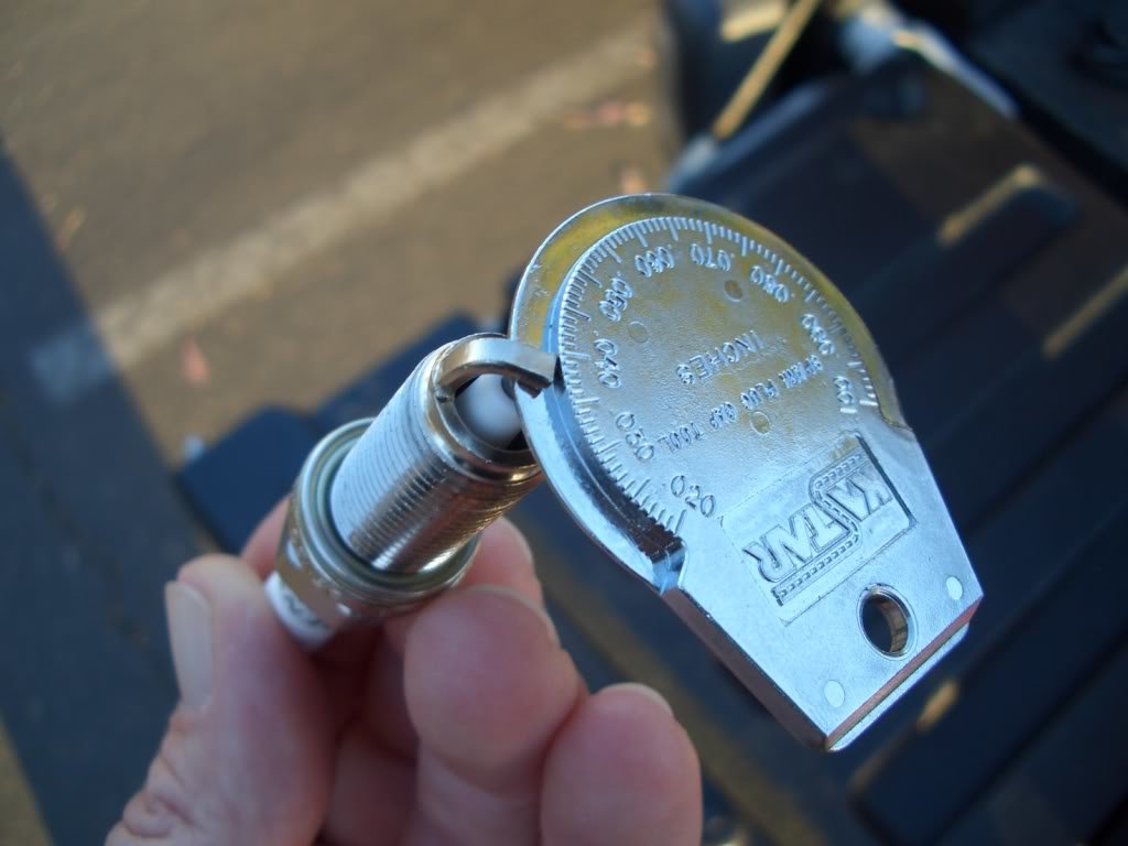

    I'll ask and maybe it'll answer that question some won't ask. Do you gap up to the edge of the plug to .040 or whatever or do you center the electrode on the gapper.
    Wish I could draw...
    l l<--gap here?, on the edge of the electrode?
    l l
    <---gap here, in the center of the electrode?

    Does this help?

    It moved when I took the pic, but the plug is gapped at .040

    Saves me from going to the Gap....they probably wouldn't know either.....
    Thanks for coming through once again Chris.
