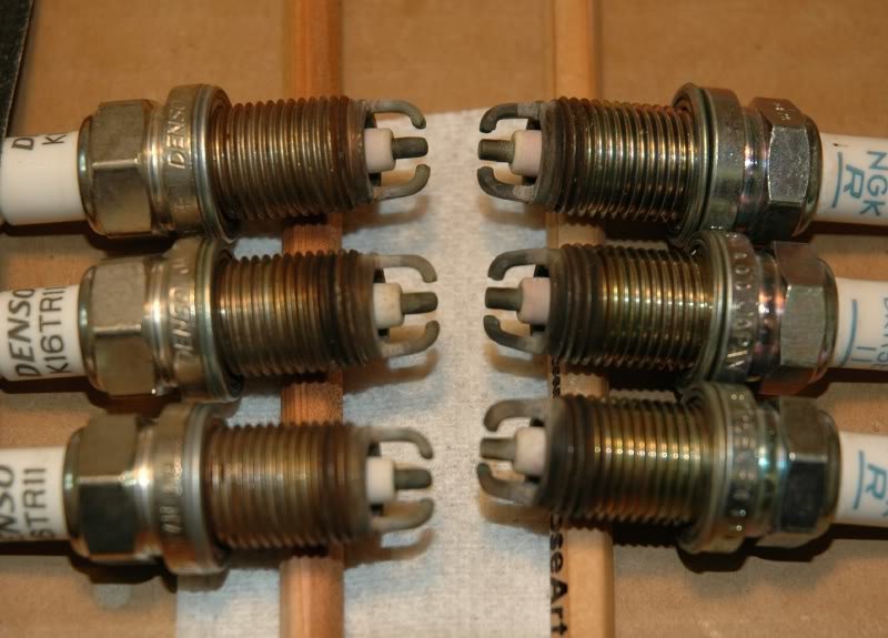

    Not only do the 5vz plugs fire twice as much as a conventional system, one side fires from center to ground and the other side fires ground to center.
    My factory plugs were eroded out to .055"-.060" at 30K as well as all subsequent changes at 30K intervals up to the present 250k.

  14. Jan 23, 2017 at 12:11 PM
    #34
    Speedytech7
    Feb 20, 2014
    #123587
    58,232
    FCQM+VG Cheney, Washington
    It's less Tacoma and more mod
    Yikes! The electrode broke off? Well then comment rescinded, although wouldn't that be possible with a new plug too?

  16. Jan 23, 2017 at 12:26 PM
    #36
    Dirty Pool
    Dirty Pool FLIES ON THE FRIES, KETCHUPS WATERED DOWN
    Mar 24, 2013
    #100471
    2,325
    59.4 Miles, 56.67° NE Of Moab
    99 XCAB V6 MT TRD
    Dirty Pool rear bumper/air tank with integrated spare CV shaft storage, DP customized TJM front bumper, 8000 lb Ramsey/Technora rope, E-locked, Extended breathers with front diff catch can, PCV catch can, SAWs with DP heim joint seals, DP custom 6 leaf rear springs/Billies, DP custom skids, 2lo, Gray wire, Cap, Bed Rug, Black steelies, 01 Center console, Map lights, Disraeli gears
    Sure, it's possible.
    These are the factory plugs out of my 5vz at 30K.
    Note the rounded/eroded center electrode on the Densos (left) vs the NGKs due to the opposite firing polarity.

  18. Jan 23, 2017 at 1:03 PM
    #38
    devinzz1
    devinzz1 Well-Known Member
    Jun 28, 2014
    #132892
    7,008
    devin
    lewisporte Newfoundland
    2023 aclb trd or mt
    icon stage 10 kit, toytec 1" bl, 35" general x3s, 17x9.5 procomp wheels, locker anytime mod, s&b intake, blackhawk 2.1 tune,
    Thats pretty cool you can see the different wear by switching the anode.
