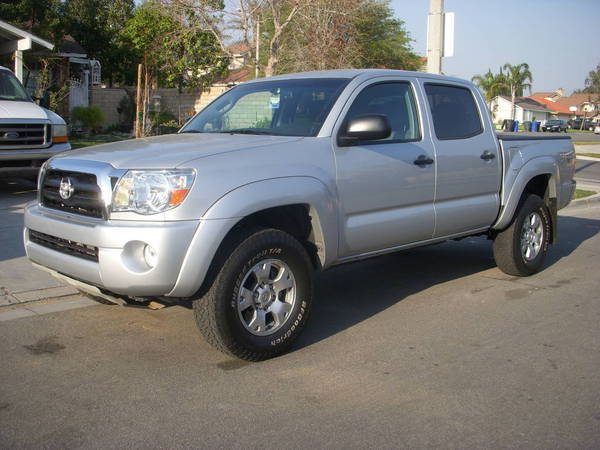

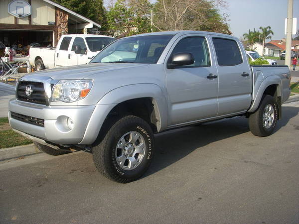

    As promised above
    Before
    After
