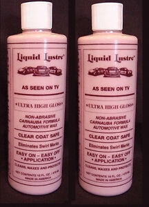

    I have used this stuff for years - might do the job for your need. Liquid Lustre was one of the original Infomercial products of the 90s - as a wax it's average. But, it will take out light scratches in paint, remover tar and dried bugs - and it will even remove paint residue from someone opening their door into yours or rubbing their car against your bumper.
    I just put a new WeatherTech bug deflector on my truck and it arrived with some light scratches and several spots where it had some surface cloudiness - typical of plastic products. I use the LL and it removed both with some light circular rubbing.
    You can find it on Amazon or directly from whoever captured the supplies of it. I always keep several bottles on hand. A note of caution, though. Watch when you use it on painted plastic surfaces with sharp corners - rubbing too hard can remove the paint.
