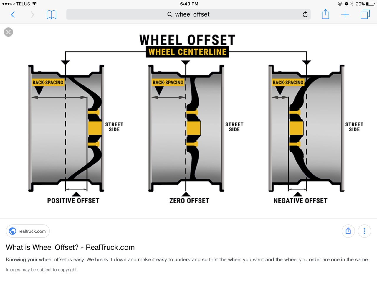

    The way I see it they are very close. The Konig Countersteer will poke out 1/8 on an inch farther than the methods. I think they should poke out around 2 1/4 more then the stock rims
