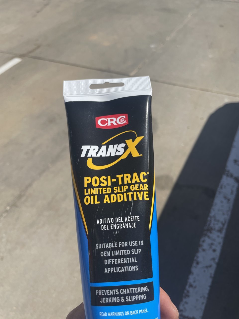

    08 Tacoma TRD V6 4x4. I changed my rear diff fluid and Im getting intermittent “lack of slip” so to say at slow speeds while turning. From what I’ve read the 08 models have a true limited slip rear and and require an additive when you change fluid. Which fluid is best or let’s say most reliable when it comes to lasting results? Thanks

    Any tube of LSD additive. No need to change the fresh oil you’ve got in there.
    You never answered my question on your other thread. Does it have an “LSD OIL” sticker on your diff?

    Sure enough it does. Little LSD only sticker. Covered by dirt that needed scraped off but it’s there

    Just figured out how to reply directly. I think. Anyway, yes it has the sticker. Thank you. I grabbed a bottle of this
