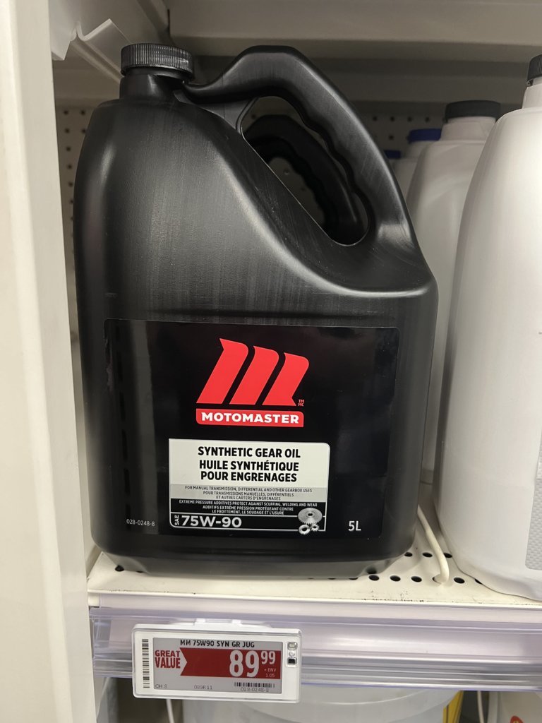

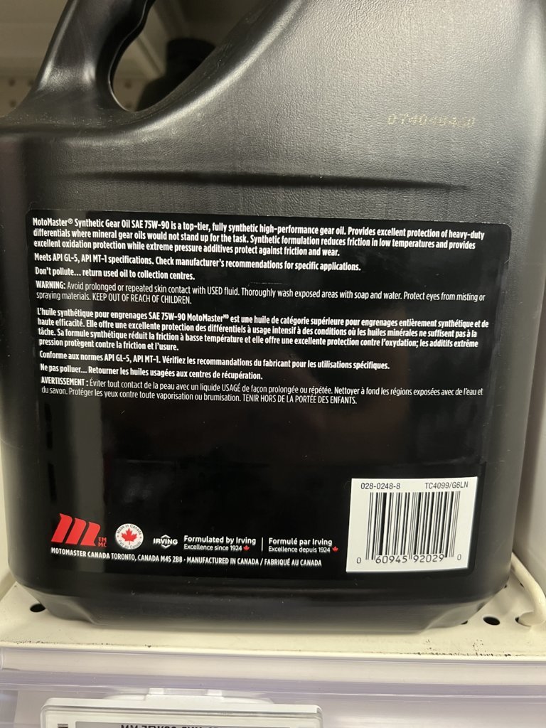

  8. Dec 13, 2024 at 6:29 PM
    TacoPandaTRD
    TacoPandaTRD Well-Known Member
    Jul 24, 2020
    #335442
    395
    TacoPandaTRD
    Chilliwack, British Columbia, Canada
    2020 Toyota Tacoma TRD Off-Road
    Always looking to modify! Check out my Instagram @TacoPandaTRD
    This is what I just recently used. Under $100 in fluid and it covered my front and rear differential.
