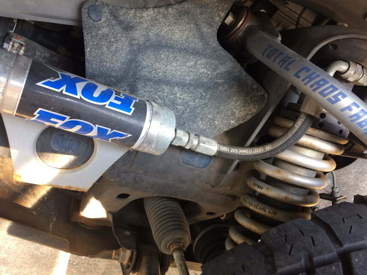

    I put a snug top on the back to keep my stuff locked up and now the rear of my truck sags a bit. Even worse when I'm carrying 800 lbs of dive gear. I'm looking to soften the ride as well. I'm running the 3.0 13" FOX springs in the front which I believe translates to 2.5-3" of lift. Still stock shocks in the back.
    I was looking at these, but wanted some input from the community. IMG_6870.jpg

    Are you still running the stock leaf pack?

    Yes, stock leaf pack.

    I just installed icon's 3 leaf progressive add a leaf and i gotta say the rear is smooth as hell. way smoother than stock. The add a leaf will give you 1.5" lift in the back and those shocks you listed will work great with them.
