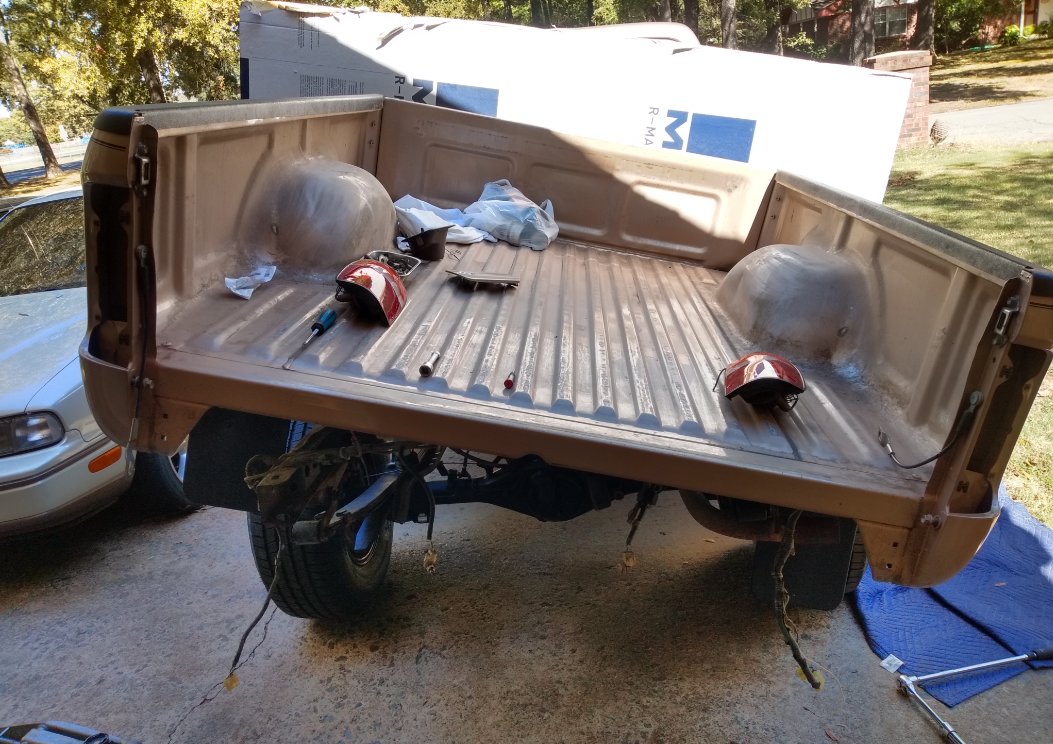

    Everything but the driveshaft. B03A - 410
    Didn't need to completely remove the bed to replace the fuel pump.
    Denso parts from RockAuto using the 5% discount code.
    Working room with the bed tilted up.

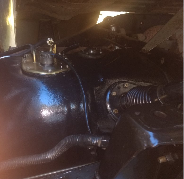

    Just to follow up. I spliced in new wires and heat shrunk them. I replaced the pump, strainer, sending unit, sending unit gasket, evap valve thingy / gasket, evap vent hose thingy, gas cap, and new fuel filter.
    Nice to have a gauge that works again and obviously a pump. I couldn’t pull the bed or I should say I didn’t want to. I’m a double cab and the pump assembly is under the cab.
    It wasn’t a walk in the park by any stretch, some hoses were a bitch to get at, but I did the work on the floor with no hoist. Thanks for the pointers on which pump to get.

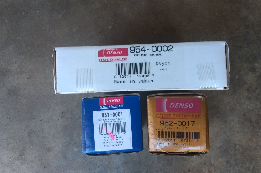

    Amazon had the denso pump for $70
