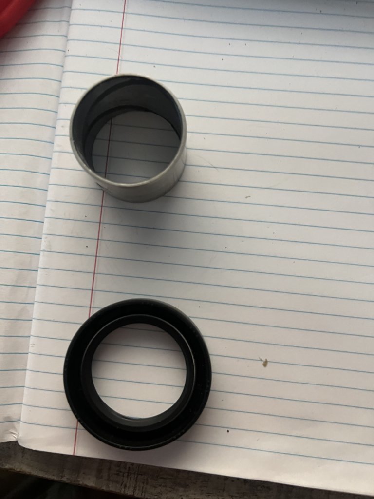

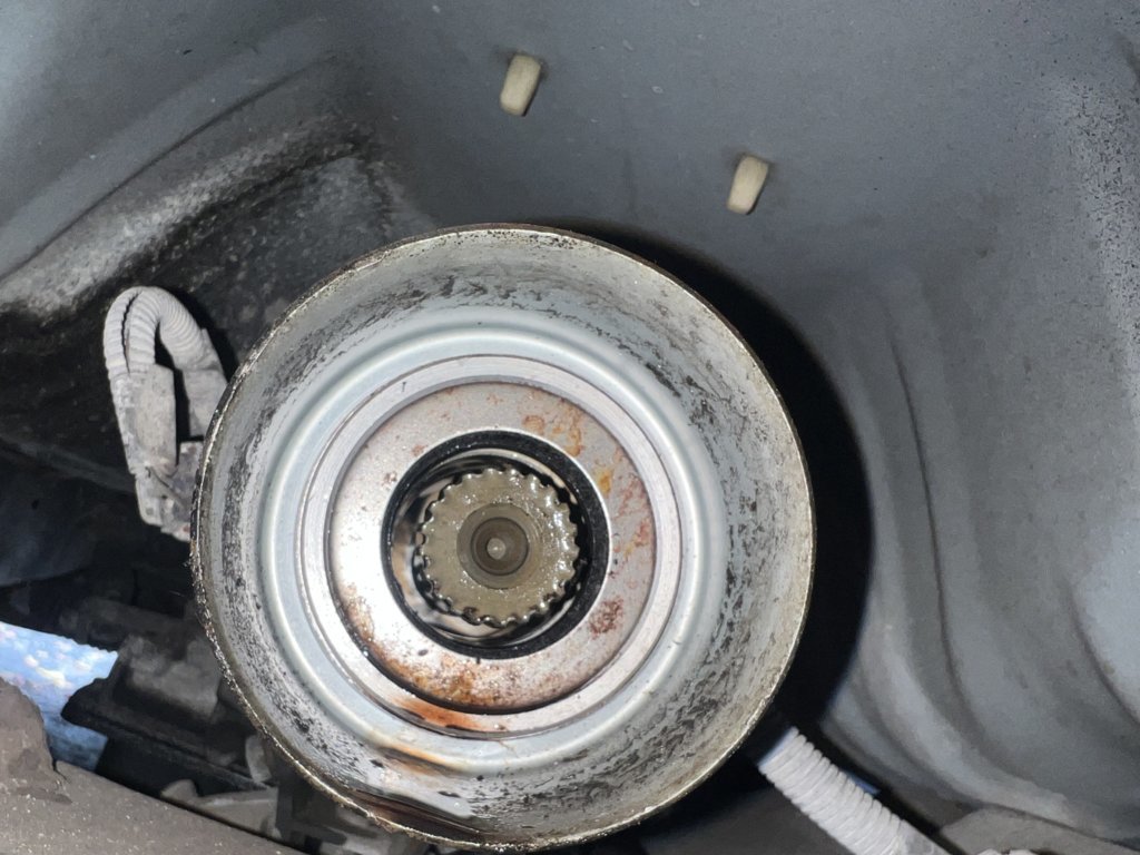

    Hello everyone i am pretty new to working on my car and it has been leaking transmission oil from this area but i am unsure what i would need to stop the leak and sounds it makes when driving. i got these pieces assuming that they could be of help but i am really unsure cause the seal don't fit. I took my drive shaft out, this is the final part i need to do . MY TACOMA IS 99, RWD, I4,2.4L

    the pix def shows 'A' seal tht is totally failed
    didnt know tht there was a seal in the 'front' of the drive shaft
    is there any big leaks where the tranny bolts to the engine?
    that 100% would be the rear main seal
    $20 part but crap ton of labor(to remove tranny) simply to tap in the seal

    Hello, I appreciate the response there is no big leaks where the tranny bolts to the engine. At least not that I know of. But you are telling me that I would have to drop my transmission?

    No!!!!!
    only if rear main seal needed
    So if no obvious leaks where engine/tranny mate up(further towards front from yur pix)
    Yur good
    Sorry I didn’t clarify

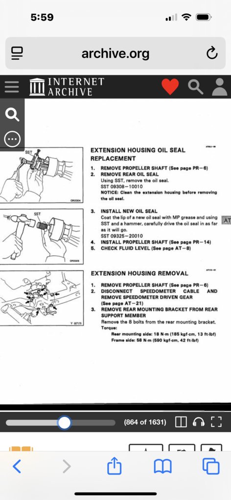

    I found this(1996 RWD 2.4)
    Not your exact model
    But
    Looks exactly like your above pix
    and what needed to RR seal

    Thank you controlcar for the help. Tried my oil seal I have but no luck. Going to check Tomorrow if I can find a piece similar to part number. Thank you for helping me look.
