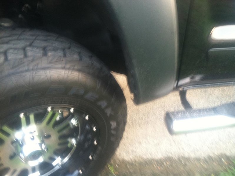

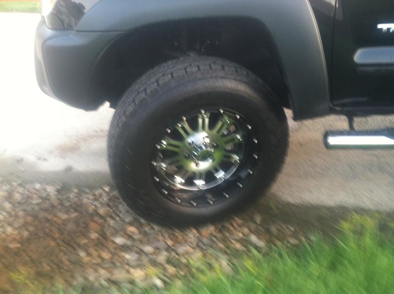

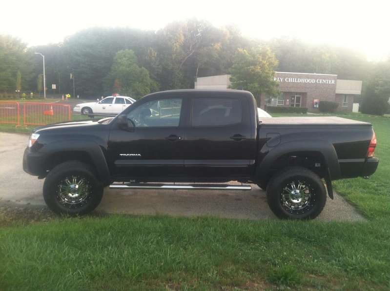

    I have a 2012 dcsb 4x4. I did alot of research and found with my bilstein lift I run an 18 wheel with 265/70/18 which is 32.6" tall but narrow enough to not require any trimming because there is no rubbing issues...( I wasnt cutting my new truck)

    The way the strut spring is indexed provides for no need of new control arms. I indexed my springs to allow for clearance. Needed no wheel spacers...4.5 offset only on wheels
