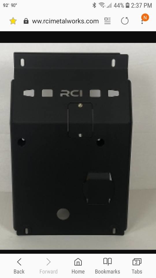

    I own a Red 2015 Tacoma TRD off road. I crunched my factory skid plate (more like splash guard) on this big rock my uncle has in his lawn to keep people from cutting through part of his yard when turning around in his driveway. So I'm thinking I should just replace the factory one now that its banged up with a real one... I don't do any real off roading but I want to be sure I'm well protected just in case something like that happens again. I've pretty much narrowed it down to these two options and I'd like some opinions on which is best.
    Option 1 -> The OEM 1/4" Aluminum TRD skid plate for $400+. (I know this is only supposed to only go on 2016+ Tacos but lots of people saying it fits 05-15 Tacos just fine)
    Option 2 -> The RCI 3/16" Steel skid plate for $320.
    Pros/Cons
    Option 1 Pros: It's a genuine Toyota part. TRD badging will look cool. Made of light weight aluminum.
    Option 1 Cons: Costs about $100 more. Not sure I like that color. Aluminium won't take on a big bad rock as well as steel.
    Option 2 Pros: $100 cheaper. I like Black. Steel is very strong and holds up well.
    Option 2 Cons: Steel is heavier and prone to rust. No sweet TRD badging. RCI isn't OEM.
    I dunno... for me this is a tough one.

    OP, I only see a pic of one real skid in your post. Not sure what the one with those red letters is. All-Pro Offroad carries an aluminum one if you want one with weight savings and rust prevention but most importantly, it's on sale right now.

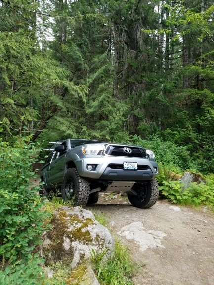

    You only have one skid listed, and a decorative piece of aluminum. The TRD aluminum skid weighs 4lbs, the RCI skid in aluminum weighs 22lbs. I'd opt for the RCI skid in aluminum over the heavy 47lb steel version. The only reason to go with such a heavy steel skid would be if you were regularly abusing it, which doesn't at all sound like your use case. I wheel my truck and use the RCI aluminum skid. The aluminum does cost $50 more, but worth it IMO for the weigh savings, also makes taking it on and off for servicing easier too and don't have to worry about rust. Most importantly it is going to stand up far better than the TRD skid.

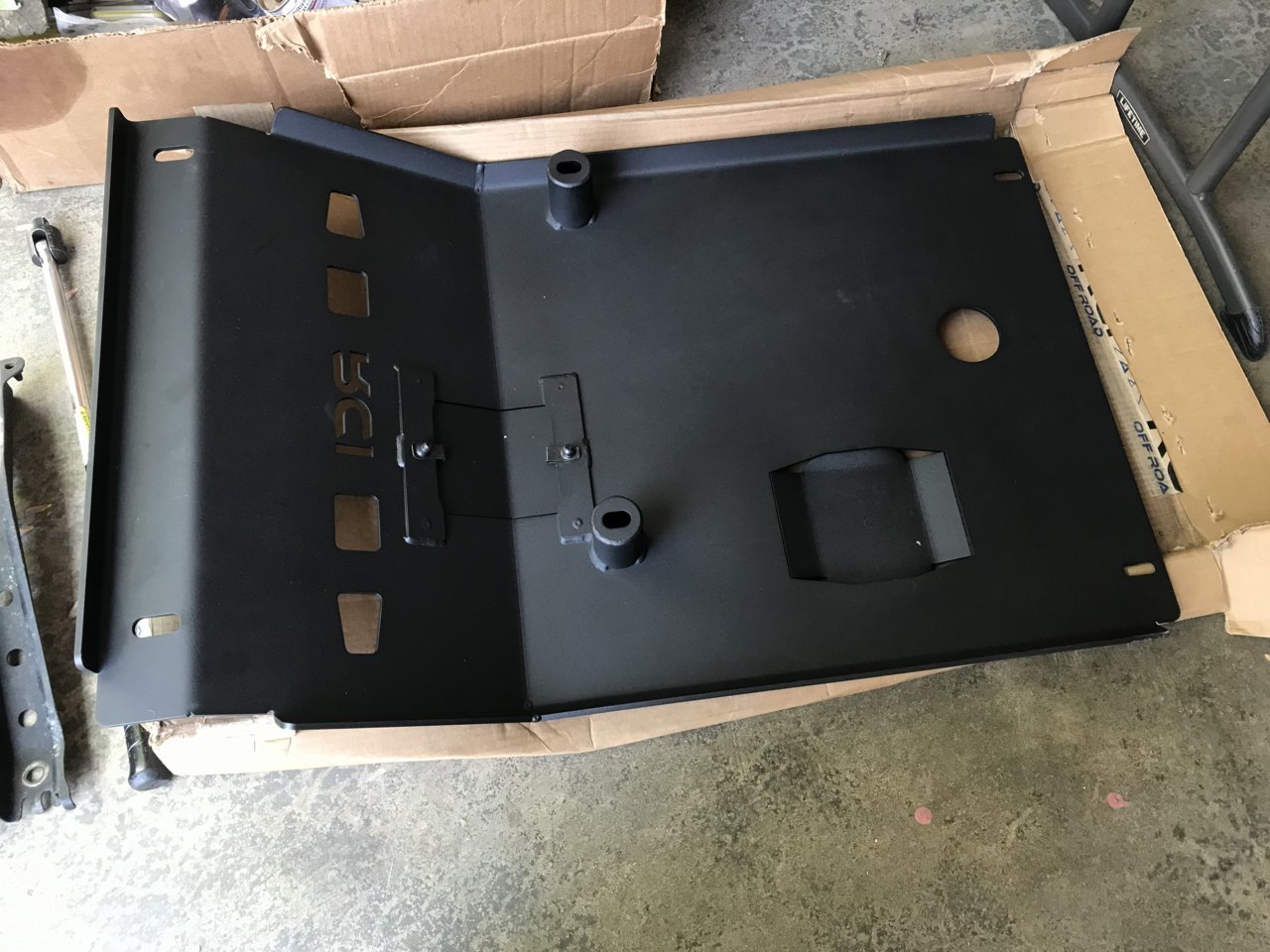

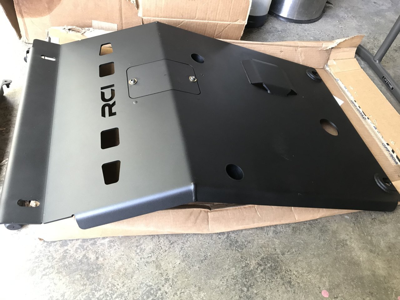

    RCI here too! I went with the RCI steel ones. They also compensate for diff drops, which I didn't think at the time.
