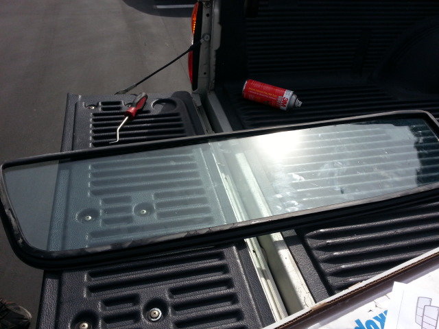

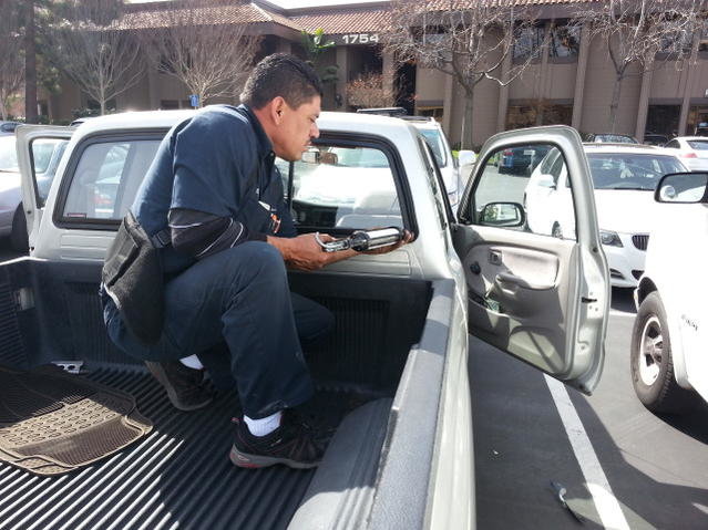

    He called this morning to say they were in his truck and was at the warehouse a few minutes away from my office. I told him to come by and show me what he had. He came by alright, but he expected to install something right then and there in the office parking lot. He had a used 4 panel factory glass but it was tinted. He had a NIB CR Laurence 4 panel in clear.

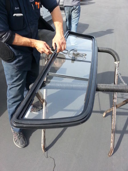

    $200 for the CRL including installation. Talk about a fast sell. He said it would take about 20 minutes. He and his helper worked so fast that they had my solid window out before I could even take a picture of them doing it. He reused the gasket as my 2001 was still supple.
    He said aftermarket might leak where the aluminum channels meet each other so he seals those small gaps with silicon which you can see him doing in the 6th picture. Last pics are in the afternoon at my house. Made in the USA.
    I kept the original solid glass and put it in the CRL box.

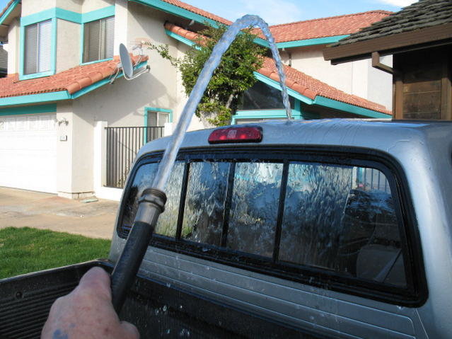

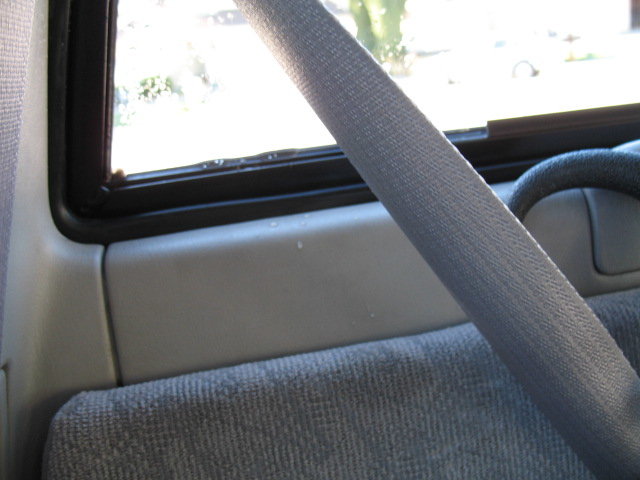

    After the install I took it home and blasted it with the garden hose on full pressure. There were some droplets on the inside. Pics 1 and 2. Then I read a slider was not designed to withstand this type of horizontal blast, or even an automatic carwash.
    Next day I took the nozzle off and pretended the water came from the sky. No Leaks. Pic 3.
    We have been a drought. Then about 3 days ago it started to rain hard off and on. No leaks. Pics 4 and 5.

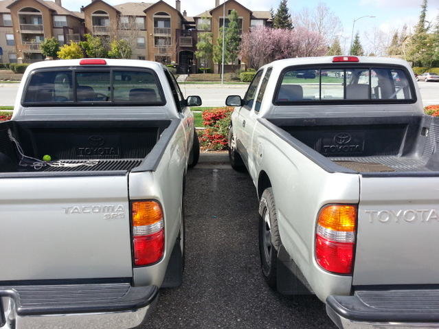

    Last pic shows the difference between the factory tinted 3 panel and my aftermarket clear 4 panel. Also notice the size difference of the window opening. The 3 panel reminds me of a cat door....
    Pilkington was the glass supplier for Toyota at the NUMMI factory to answer my original question.
