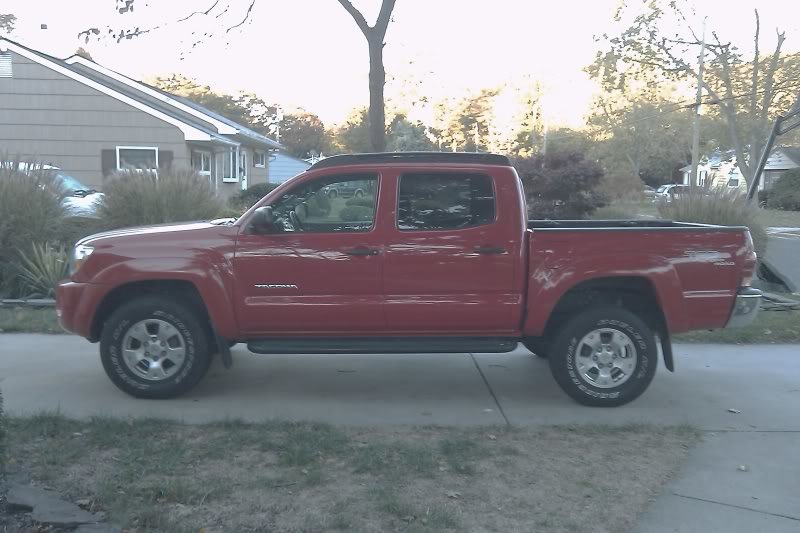

    So I "need" new front springs to level out my Double Cab. However I cant figure out which ones to go with. IF I do OME springs, which ones? 883, 884, or 885? I worried that the 884 and 885 might give me to much lift and Ill have to worry about CV angles. I do not want to install a diff drop. I only wanted to lift my truck a little bit. I have Toytec 2" AAL in the rear. (or 1 1/2", whichever it really is). I plan on going with Bilstein 5100s, but I will be keeping them at the 0 setting. I dont want to adjust hieght with the shocks. I thought about going with Eibach, but most of the pictures Ive seen, do not look like they gave very much lift at all. Would the higher spring rate of the 885 be better for my DOuble Cab? Or WOuld I only need the 883s? Help!
    As it sits now:
