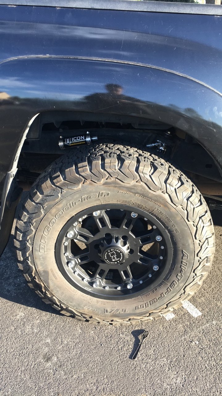

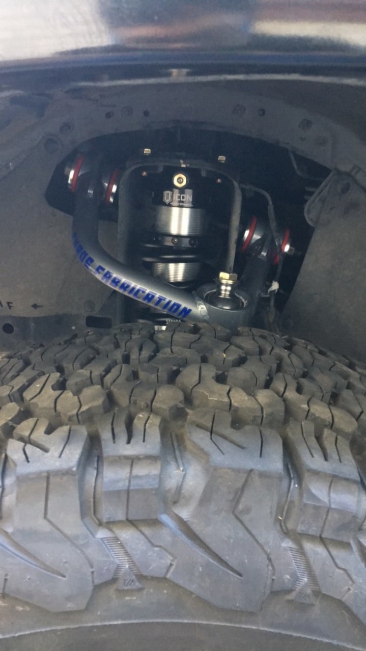

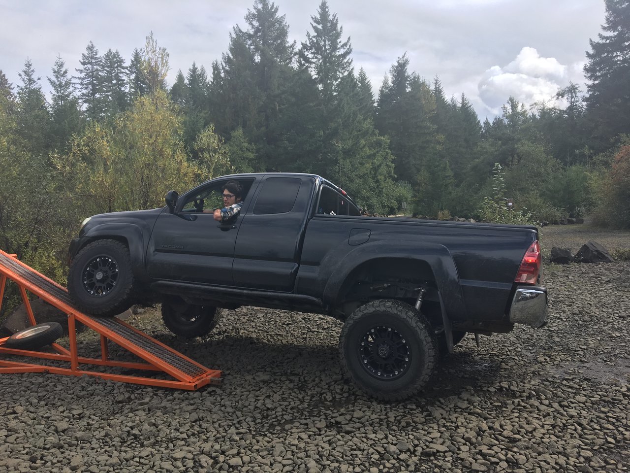

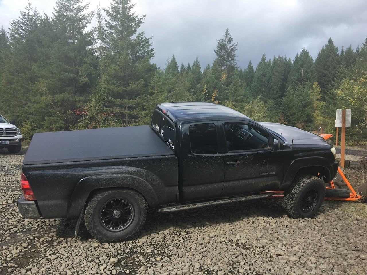

    I run icons stage 3 with TC UCA and (this is ridiculous but bear with me - thanks a lot Toyota for getting rid of my AAL and giving me this crap with the recall) 2016 springs and a deaver AAL. No complaints, had em about 10-15k and they are much better than stock. I used to run a simple hockeypuck lift in the front and a aal+tuffcountry shock in the rear.
    msommer1420 likes this.
