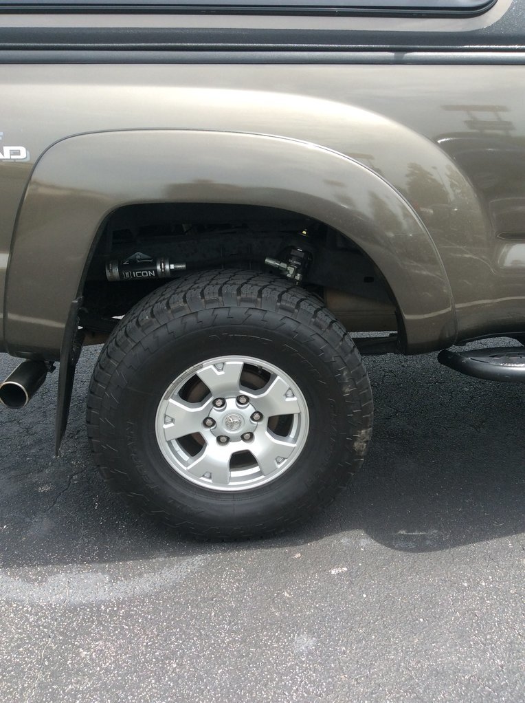

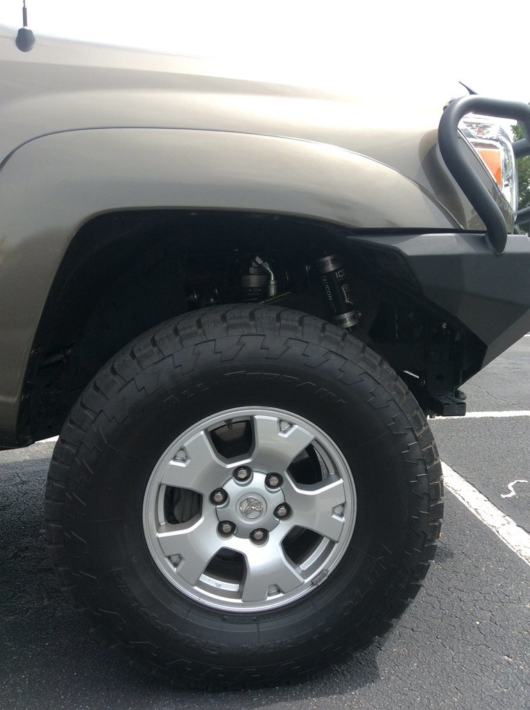

    I went through a similar decision making process and opted for the Icon Stage 7 with the round uca’s Instead of billet. Best choice I’ve made so far with my build. I couldn’t get over the grabby brakes and front end dip when stock, coming from a 2500 LTZ 4 door long bed Duramax Chevy. It’s a rediculous amount of money but the on road and off road ride and handling (two different things! Lol) are fantastic. I combined the Icon suspension with AllPro Expedition springs, timbren bump stops and an All Pro shackle flip kit. I just got back from a trip where we rode for days off road in the NC and GA mountains and tackled the roughest (steepest,rockiest,sandiest, stream crossing est, muddiest, twistyist) conditions I’ve driven in with the truck to date and I’m super happy with my set up. The Stage 7 system comes with dual adjustable shocks so you can customize each stroke to your liking or based on weight and conditions. I run a 2015 TRD OR acess cab long bed with an ARE topper and a 23-0 RTT, road Armor front bumper with winch, all pro Apex sliders and 33” tires. Only change I made to the set up after install was to upgrade to the 700# springs after putting the front winch bumper on. I drive all kinds of bad asphalt, highway and dirt, and trails. Better ride, ability to go faster in any conditions and much much better handling across all driving conditions. Very happy with my set up. The All pro expedition springs really opened up my ability to have heavy loads and comfort with almost no chance in stance or length of stroke in the rear. I’ve put about 4000 miles of off road driving under the truck since buying it last year and I have all but about 200 of those miles on the suspension as described.

    I love this. Works great for me.

    Great looking truck! I like how you kept it clean original modified look lol. :thumbsup: your suspension sounds awesome. I've heard good things about the allpro springs. I think I will try them out on my next build.

    Thanks man. It’s a work in progress. I just took off my tent today and increased the softness on all the shocks. The expedition leafs are truly progressive and are fantastic,especially if you run variable weights in the bed.
