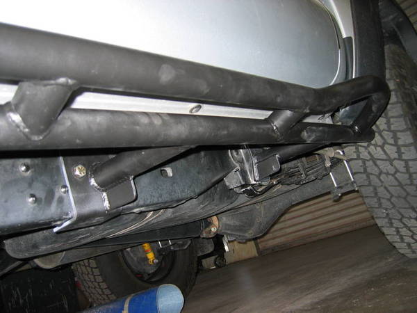

    Yup..Got em on:D See more pics on my home page!

    i looked real hard at the crushers and then opted for the hybrid style. one factor was weight difference. (ya, i know a few extra pounds won't hurt, but i plan on having quite a bit of steel bolted to this thing when i'm done) the other reason i didn't get them is dirty pantlegs. i caught my leg on the stock tubes all the time and did not want to continue. the hybrids upward angle instead of straight out has cured this problem for me. you are right tho Silver...the crushers are pure beef.
    looks good Stevi...though i would like to see some gussets on the top of the mounting tubes.

    those look great! :D

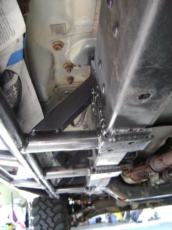

    Not my truck, tundra from over at pattora. This is the proper way of bracing off sliders so you don't get any deflection.

    If you gusset up the sliders like that, are you in danger of twisting the frame? I've given serious thought to having gussets put on my All Pros to shore up their strength, but don't want to put the frame at risk...
