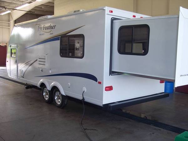

    My new camper (picking up Thursday). 2011 Jayco 213. Empty weight is 4,400 lbs, max weight is 5,500. Length is 24' total.

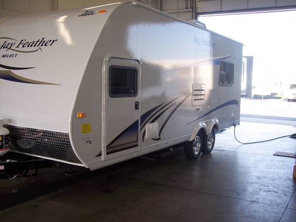

    Here are some pics of the new camper.
