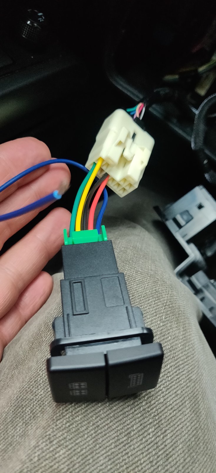

    Just a quick follow up on this...
    I opted for an aftermarket dual switch that will control the cargo lights and some front lights. Pulling together information from threads here plus my own knowledge and testing, I ended up with a very clean install.
    I bought a connector shell and crimp terminals that mates with the OEM cargo switch connector so that I didn't need to cut OEM wiring. I avoid that whenever possible.
    The switch diagram/instructions are poor to say the least. What I figured out is that black is ground (bonus points there) and yellow is backlight illumination positive. Red is the dual switch COMMON, and isn't connected to anything other that the two switch contacts. Green and blue are the top and bottom switch outputs.
    So, what this means is that polarity on the switch wires doesn't matter (contrary to the crappy wiring diagram from the switch seller). I wired the common to ground, and was left with two ground-switched outputs. One of these went back through the connector to control the cargo lamps. The other will ground a relay that supplies power to my front light circuit.

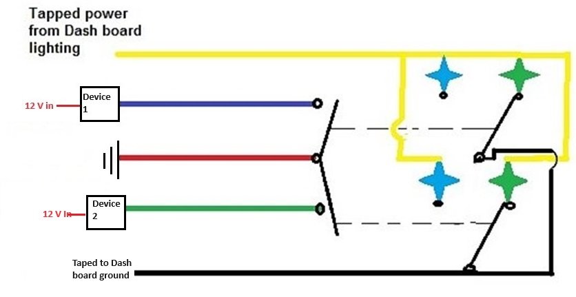

    I was disappointed with the vendor also. My switch did not have any information with it. I did make a very amateurish sketch. Can't even call it a schematic. But it shows what is going on.

    Yup, looks about what I found.
    I was testing in daylight. Later when it became dark, I found the the switch to be significantly brighter than the others. I usually run my dash lights very dim to preserve night vision. I suspect the illumination is controlled on the negative side, and if so it will always be full brightness the way it's wired.
    The potential solution is to disconnect the black wire from the white/black (GND) and connect it to the ILL- (need to check colour).
    Otherwise, everything is working nicely.

    So you did a Ty Webb...
    (See my next amateurish MS paint rendition below)

    Each switch led has an associated resistor that determines the maximum brightness. Grounding the black wire keeps it at that level whenever the switch has power. An additional resistor on the black wire can dim them more and/or get them in line with your dash leds if you connect the black to dash lights negative. On all of these switches the black wire is for the switch leds only and doesn’t affect the switch operation.

    I get that the illumination circuit is separated from the switch circuits. I wish this was made more obvious by the sellers by providing a clear internal schematic.
    Looking at the factory wiring diagram for panel
    Illumination, power to switch illumination comes directly through a fuse. The negative goes through a module, leading me to believe that it's doing ground side PWM to control brightness.
    ...at least, I assume the OEM switch backlighting is dimmable... I'll have to confirm this next time I'm in the truck with darkness. Shouldn't be too long from now this time of year!
    If so, I'm going to move my black wire to test this theory and try to get the switch illumination to dim variably like the others.
    On the other hand, I do sort of like how it stands out... but maybe too much and causes a distraction.

    I go in and replace the resistors as needed to match oem switch brightness so they dim correspondingly. Some are close but some need to be much dimmer like on the door switches. Doing it at the black wire is less invasive but not as clean even if you don’t see it after install. Since I sometimes change led color as well it works for me to do it all on the pcb.
