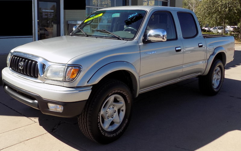

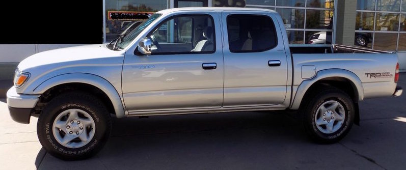

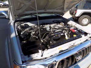

    The glare off of those chrome mirrors is like looking at a welding arc. I'd be painting over that chrome and replacing the yellowed headlights (they're cheap online). You've got yourself a really nice platform to start a build @Tonkoma Kid

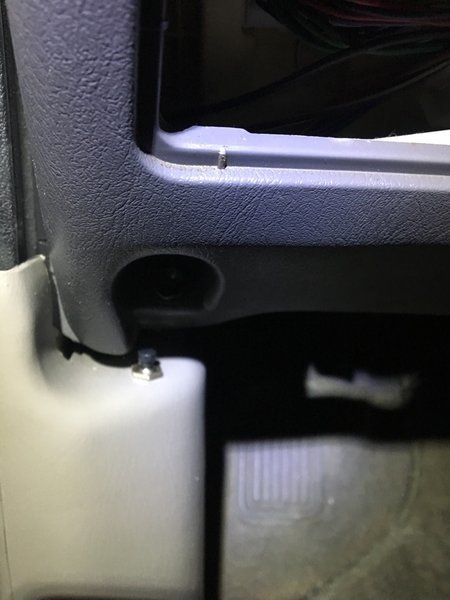

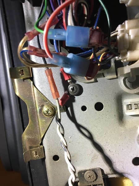

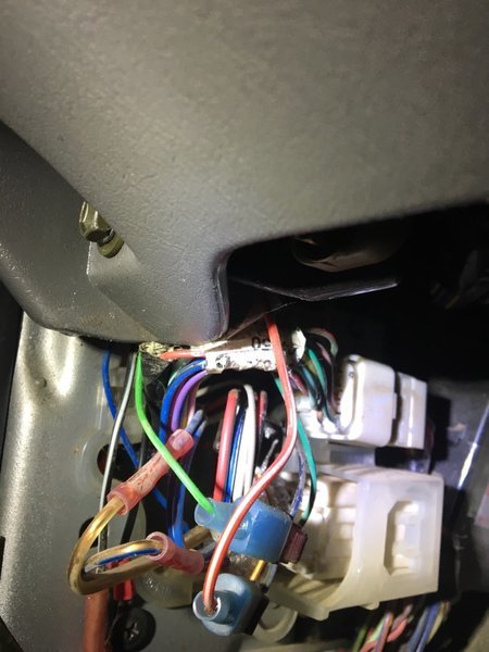

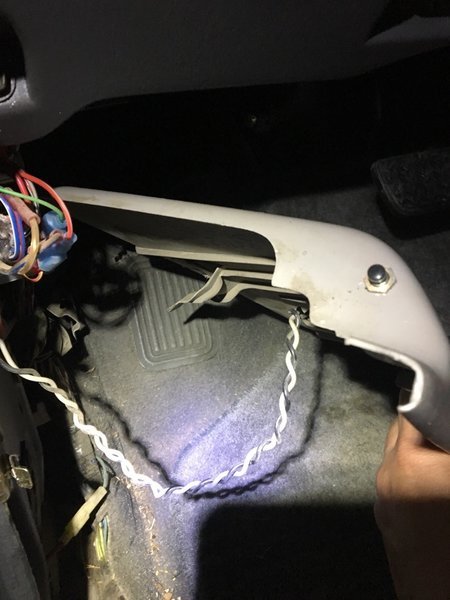

    unfortunately once I got home with the truck (after 10 hours of driving) i started having some ghosts in the machine. No issues the entire way home, then as I was cleaning up the truck, suddenly the doors started locking and unlocking on their own follows shortly there after by the issues with the electric windows. The locks fired a handful of times on their own with no issues with the windows. then the windows suddenly stopped working (all 4 windows at the same time) regardless which window switch i used---all 4 windows and all 4 switches. When the windows were not working the locks were.

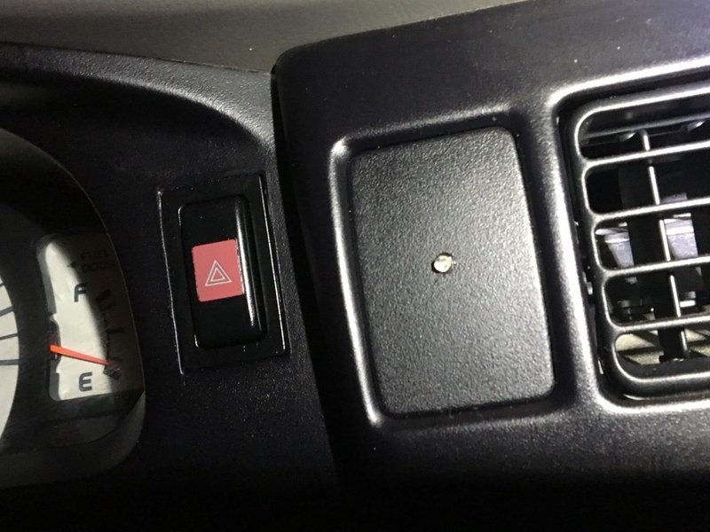

    I believe this is likely a short somewhere. I took a look at the wiring and found this switch (I believe it is for an after market alarm system) because there is also a small led in the dash, some pretty poor splicing etc going on down there.
    any other opinions or thoughts other than a short (probably brittle wire cracked/now shorting out?)
    the fuse was fine, and then after removing connections, blowing them out and reconnecting they once again worked, only to stop working after a few min later.
    I will pull the boot between the door and the cab and see if I can find any split/cracked wires...if there are other things I should be looking into, let me know.

    Woah, that's some messy wiring! If you think the aftermarket alarm is possibly interfering and causing problems, I would try to reset it and see if that changes anything. No idea if this would help or not (I'm a noob as far as electrical issues goes) but it may be worth a try. Just a suggestion.
