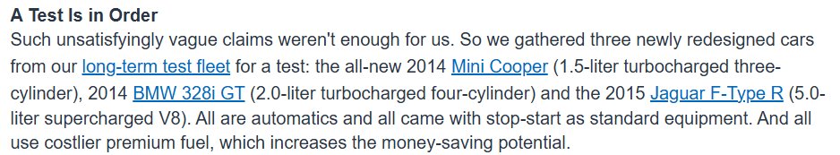

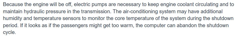

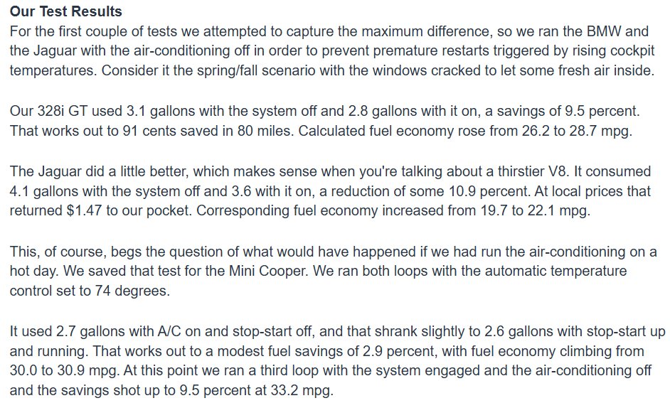

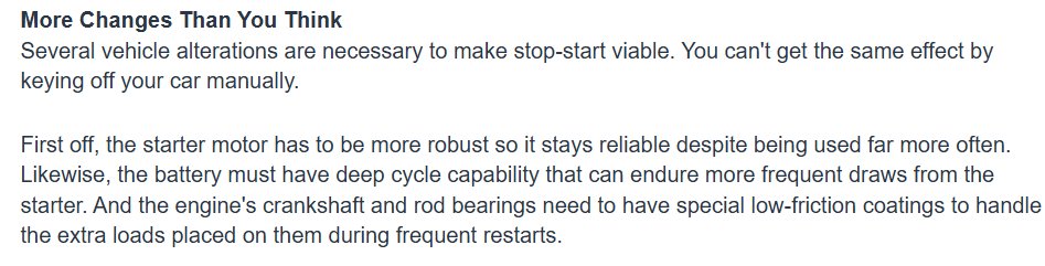

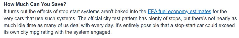

    Full article here: https://www.edmunds.com/car-reviews/features/do-stop-start-systems-really-save-fuel.html
    TLDR: Auto Stop/Start saves about 10% and those savings aren't included in the EPA ratings. Savings go down to 3% with AC on, could be more savings if there is more stop time in your stop & go traffic. Hybrids have an inverter AC compressor so you can probably go 5-10 minutes (depending on OAT) before engine turns back on. They will get all/most of that 10% savings.

    It's a heavy duty starter designed for this and the "supposed" better mpg was tested to be relevant, but if you don't want it either don't use it or don't buy it.
