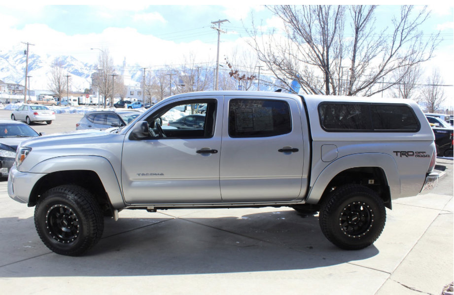

    087F98A7-9630-42FB-9FDD-B0D0E0ADD5BC.jpg I haven’t noticed the TRD markings on the shocks. May have to look again.
    But here is a photo.

    Definitely lifted. How that is accomplished matters to some, others, not so much.
    I see bare trees and snowy mountains in the background. Is this a region that uses corrosive salts or brines on the roads? If so, re-read post 3.

    I believe maybe it was lifted after the fact. I didn’t see any blocks in the rear. Sorry yeah I meant to say coil overs. But definitely have Bilstein shocks in the front. I failed to take pictures of the under carriage.

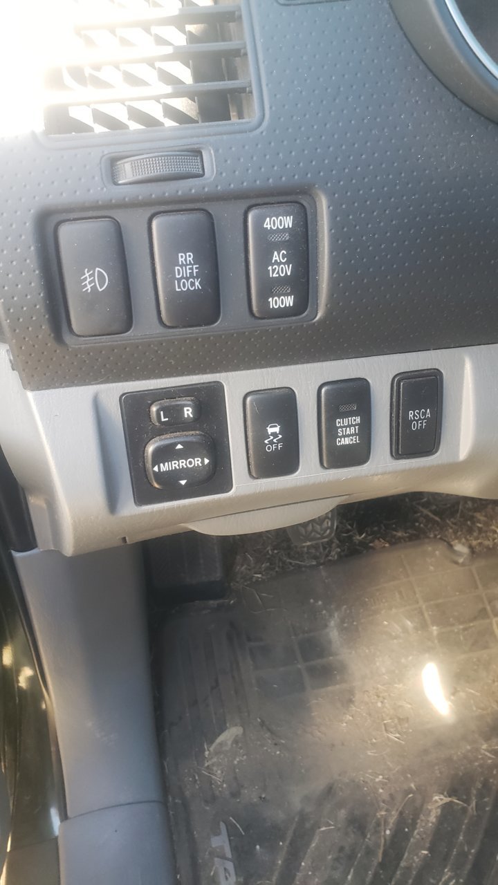

    Make sure it's an actual TRD OffRoad and not just an SR5 with TRD stickers.
    The easiest way to tell is by looking for the locker motor on the rear diff and RR DIFF LOCK button on the left of the dash.

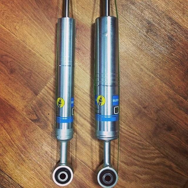

    Sounds like it might have bilstein 5100 (left) or 6112 (right). See pic below.
    I wouldn’t worry about the shocks as it’s a fairly cheap part to replace.

    Here's what the button lineup should look like on a 12-15 TRD OffRoad (note the clutch start cancel button is on a manual, automatic will have a DAC button there). There should also be an A-Trac button in the center dash under the A/C controls on a 12-15 TRD OffRoad.
    @TnShooter may have a pic of the locker.

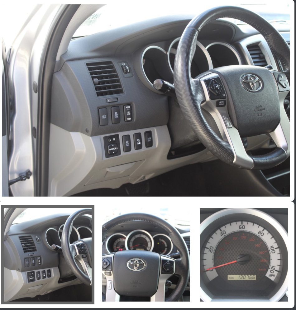

    DM93
    I just found this pic that was sent to me by the sales man. Seems to be an TRD off-road

    That's good, never hurts to check as there are alot of fake ones out there and most dealers are clueless about it.
    In addition to the frame check for the timing cover oil leak behind the power steering pump as that can be a labor intensive repair if it's leaking.
