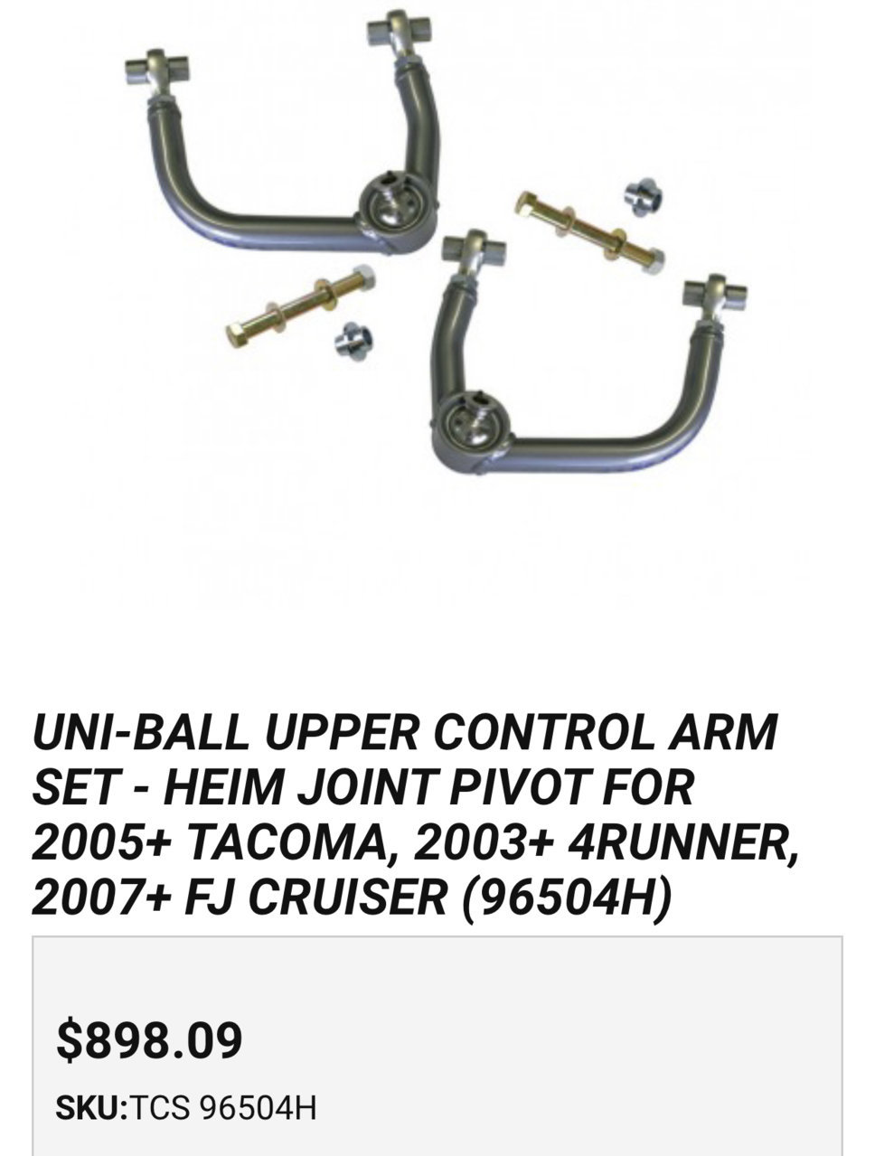

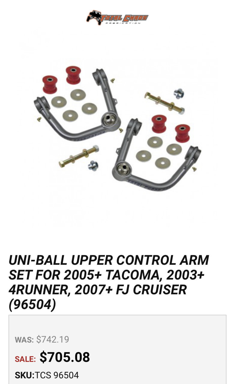

    Hi, I’m on the market for new UCAs and TC makes two different kinds. Trying to figure out which one will be best for me?
    75% highway driving
    25% off roading
    Current set up, Kings 2.5 w/ res on 285s. Thx

    If you choose TC, stay away from the heim joints. They're good joints but not meant for street use. They'll wear faster. The standard bushing joint will last longer and will do very well off road too. Aside from cool factor and more maintenance of heim joints, you won't notice a difference unless you're racing your truck.
    As for icon vs tc, I would stick to tc. They're more proven than icon but that's just my opinion.

    Thx @svdude. Looks like I’ll stay away from heim joint then.

    100% right. Heim joints are not made for your setup. Get the uniball. I have been running them for 25k miles now. They’re great.

    I’ll correct myself slightly... Can’t go wrong with SPC, JBA, Icon or TC - but heim joints are a no no with the setup you’re looking to install.

    The heim joint system offers more adjustability which is necessary on larger drop bracket lifts or applications where customers want maximum adjustment. With your suspension setup and tires, the standard Polyurethane Bushing Upper Control Arm will be just fine. It will help reduce any wandering or darting of the vehicle and make it easier to align.
    We aren't too far from you (Corona, CA), please reach out if you have any questions or would like to order a set of Upper Control Arms
