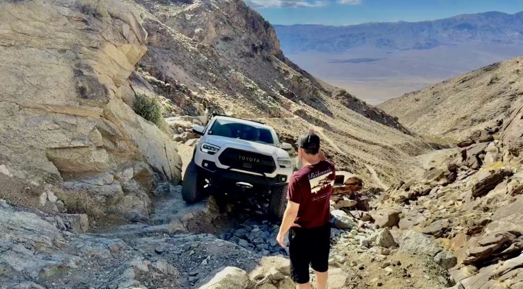

    SL’s all day IMG_4900.jpgDeath Valley trip no issues. Went through 2 sets of geolander g003 MT’s. So glad I made the switch.I slashed inner side wall on the geo’s on a trail. Daughters boyfriend on stock tires no issues. Just depends really. Ride quality to me is important on and off-road
