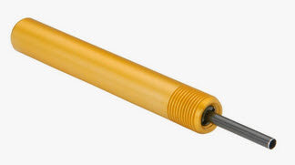

    Those look like Molex pins to me.
    Molex pins were used in the 70s computer industry, and I suppose they are still used today. They were more or less reliable. I have a tool that was made my Molex to remove the pins from the connectors. You poke it over the pin and all the way down into the plastic connector. When it bottoms out, it has compressed all of the little tabs that prevent the pin from backing out of the connector. You can then tug on the wire and pull the wire and pin out. Here's a photo:

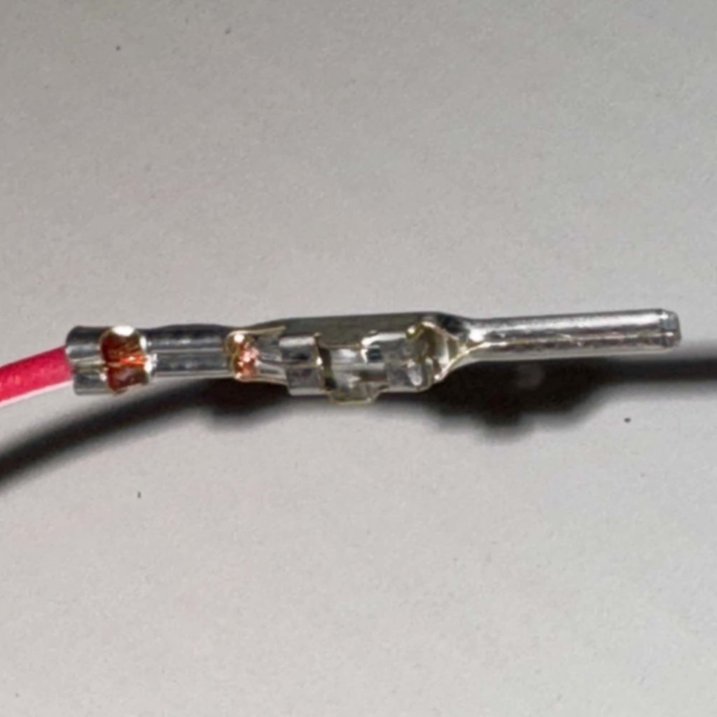

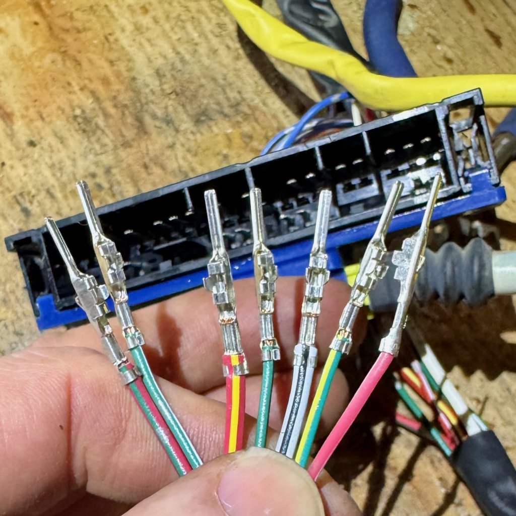

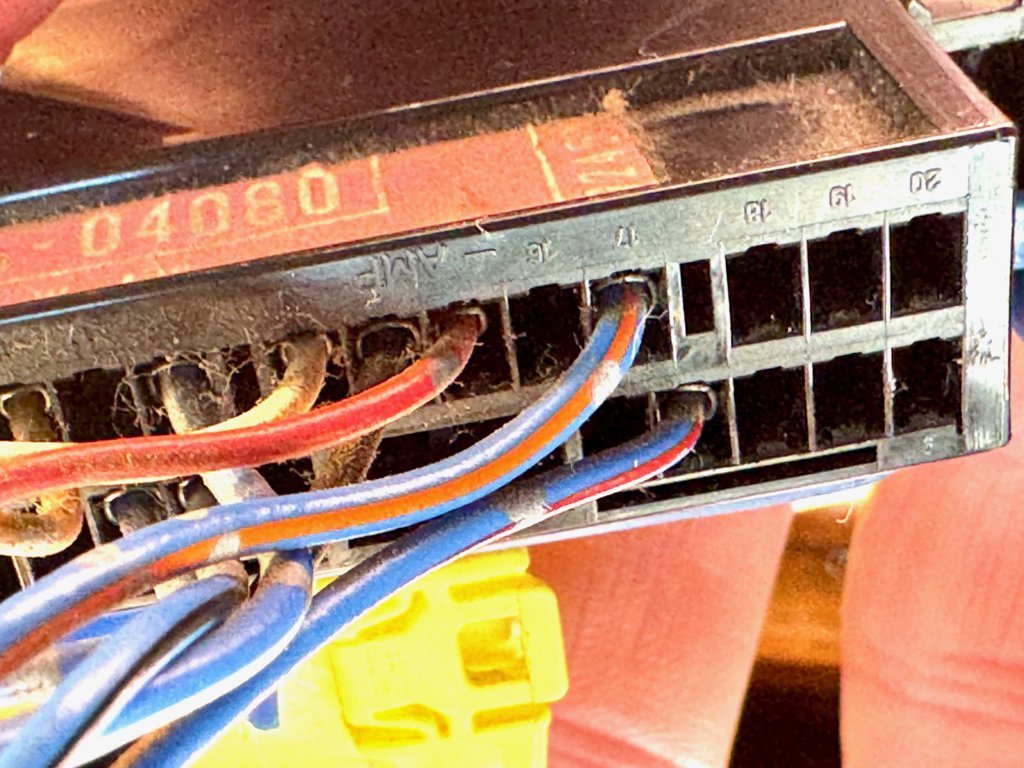

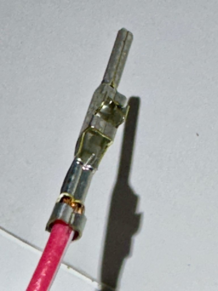

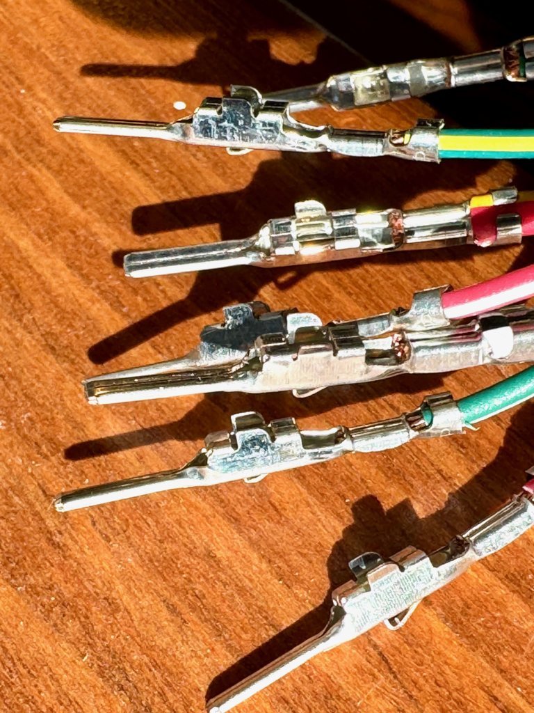

    After trying for quite while, I still cannot get these pins to move at all. Thus far I've tried:
    Below are some additional pictures of the pins. Perhaps if I knew what part of the pin I was trying to move or dislodge, it would be helpful. I don't see the plastic connector that @skeezix mentioned. Thank you.

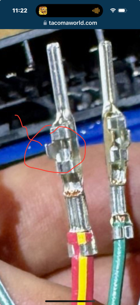

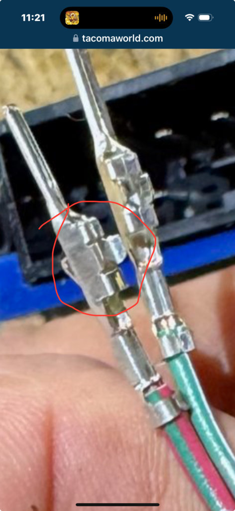

    Ok I think these are “afixers/pressure pts holding pin wire in plastic the pigtail
  14. Mar 1, 2025 at 9:28 PM
    ControlCar
    ControlCar My Moto: Help & Learn…period.
    Jul 22, 2023
    #429578
    3,066
    Steven
    Sugar Land TX
    1996 Taco 2.4L 2wd Automatic
    Clock Volt meter/LSPV Delete/Hyundai 16’s/FP gauge/after 9months of wrenching ZERO oil leaks
    IMO
    Either
    -2 picks needed for one pin/wire
    -some kinda release flap on plastic pigtail

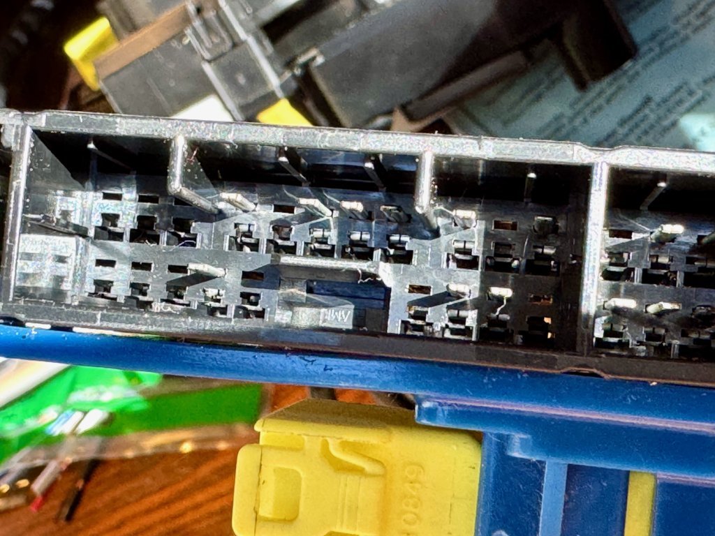

    Can u post a pix of the plastic pigtail?
    Like what those pins insert into
  16. Mar 3, 2025 at 2:50 PM
    #16
    foothill96tacoma
    foothill96tacoma [OP] Well-Known Member
    Jun 21, 2018
    #257030
    428

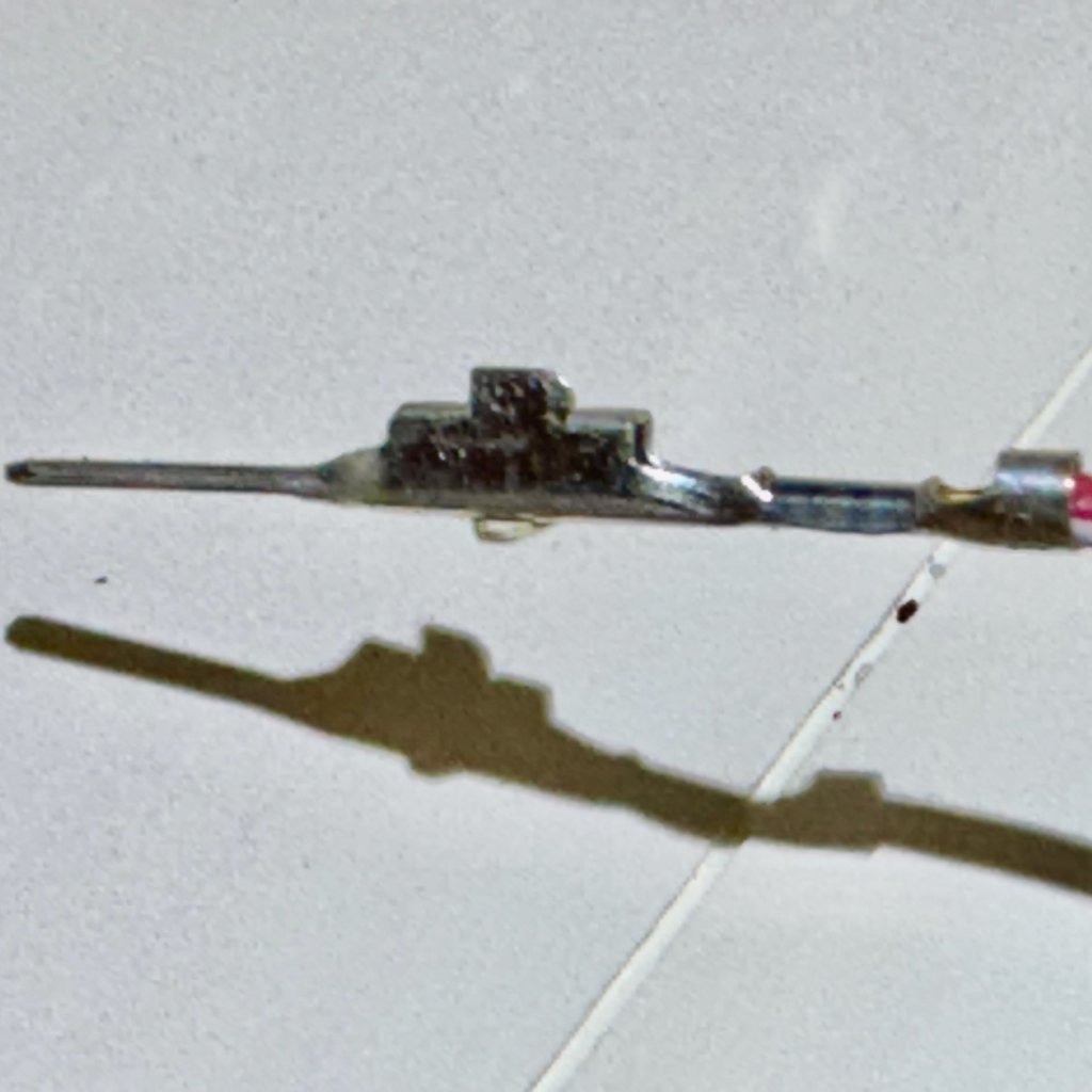

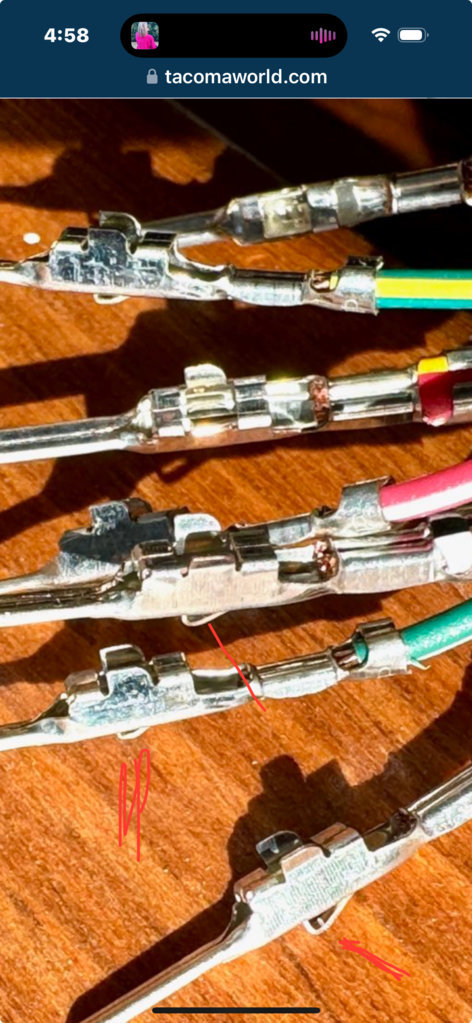

    Still no luck. Here are some additional photos that may help us solve this puzzle: IMG_7762.jpg IMG_7764.jpg IMG_7765.jpg

    Hmmm
    Looks like there is a release pin/tab on the bottom of said pins
    Here:
    Bc of the angle of release tab, appears would have to be accessed through the back of black ECM pin holder (squares)
    have u tried that?
    TACOTU3 likes this.
  19. Mar 3, 2025 at 7:56 PM
    #19
    Citron
    Citron Well-Known Member
    Sep 11, 2020
    #340518
    179
    Oklahoma
    2012 Tacoma TRD Sport
    Can you post a pic of the back of connector straight on? I am thinking that the tab on the bottom is acting like a spring to keep pressure. The square towards the wire on the top, behind the two prongs, may be where the latch is. A lot of times, you need push or pull the pin before you can release. I would try pushing the pin in, holding it there, while back probing to push a tab down on the connecter. If you look in there with a good light, and push/pull the pin at the same time, you should be able to see what is stopping it.
