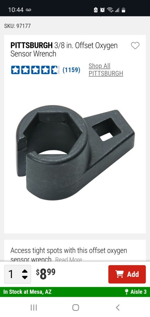

    Hi All! I was able to replace 3 of the 4 Oxygen Sensors, but the last one , Bank 1 Sensor 1 (passenger side , most forward) is somewhat blocked and I can’t get any leverage to loosen and replace it.
    Does anyone have a tool they recommend or, is there another method I haven’t learned yet?

    Thanks for the reply’s. I will clean the MAF and the Throttle Body. I changed the plugs about 4-5 years ago.
    The codes are: P0037, P0051, P0057.
    I have the proper Offset O2 Sensor Wrench but unable to get the last one to move because it’s very difficult to find an angle to get any leverage and, the sensor is in there tight! I tried putting some penetrating oil in there but it hasn’t loosened up.
