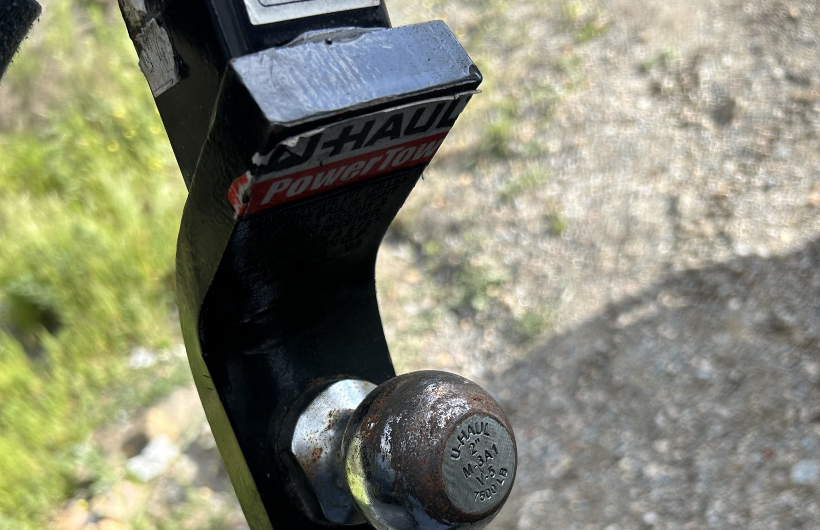

    Does anyone know what hitch is needed to pull a U-Haul?
    6x12
    Just pulled mine out, surprised to see it's rusted after just sitting behind the seat
    don't know if the ball can be saved, polish and grease, or needs replaced
    Not sure if this is normal wear from 1-3 trips
    Gonna spray rust remover acid enough times to let it work, rinse off, and re-evaluate condition

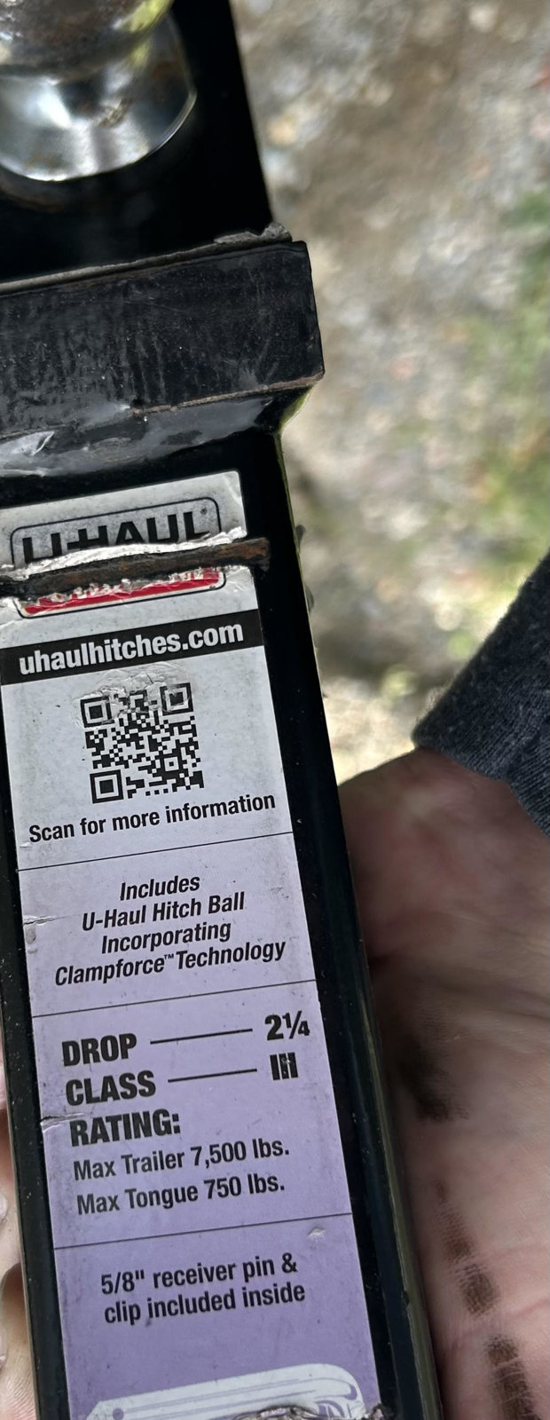

    so, this is what I have. 2 1/4

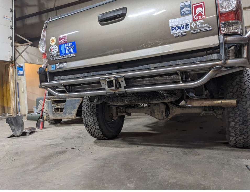

    rear bumper is WarFab Phantom HC (different truck in pic to show bumper)
    no body lift

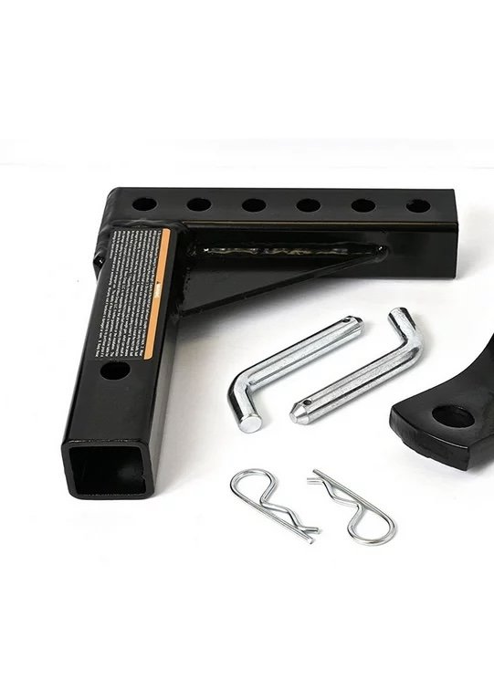

    picked up the HFT adjustable hitch
    read reviews saying it's loose. Hopefully that's old and fixed.
    If not, they have anti rattle product for this; u bolt and plate.
    However, doesn't appear it would fit tight clearance of Warfab rear bumper
    looking into other solutions

    I think the adjustable hitch will be great
    It’s not much more than a non adj
    And warfab website even says it’s basically needed for their phantom HC rear with how much higher it makes it
    that being said, took a look at HFT reviews on it and read all the 1/0 star ones where chief complaint a couple years ago on the product appeared to be looseness making it feel like the trailer was flailing everywhere
    and it appears they came out with their “anti rattle” thing as a bandaid. If it works it works.
    only issue is for that, that product likely wouldn’t fit as the warfab hitch is tucked in pretty well (high clearance) without hitch protruding for the HFT product to grab onto
    so I’m going to see what other anti rattle solutions exist that may be a different design that could fit. Like the one above that inserts into the hitch instead of clamping down around the outside.
    if I load the truck and it sags, the adjustable will give me the adjustability to set it to the right height.

    thanks. Will confirm hollow. That looks like a good option. And nut/bolt that’s not quite as easy to steal. Among other anti theft methods.
    I might be able to use the Harbor Freight anti rattle clamp get it to fit by flipping it upside down
    However it appears the downfall is it clamps onto the bumper hitch, which could damage the powdercoat
    as opposed to internal shim threaded bolt style may not. And more of the clamping surface (shim) is acting on the cheap replaceable HFT Adjustable Drop unit ($50) rather than the bumper.

    I have a bumper with hitch about where yours is. I use an 11 inch drop. That adjustable should get you where you want it.

    I towed a 6x12 uhaul with an 8" drop hitch and it was good enough, I would have preferred a slightly lower ball height but it was fine for a rental trailer. I have a hitch height of 28" off the ground. 2" lift and super HC bumper.
