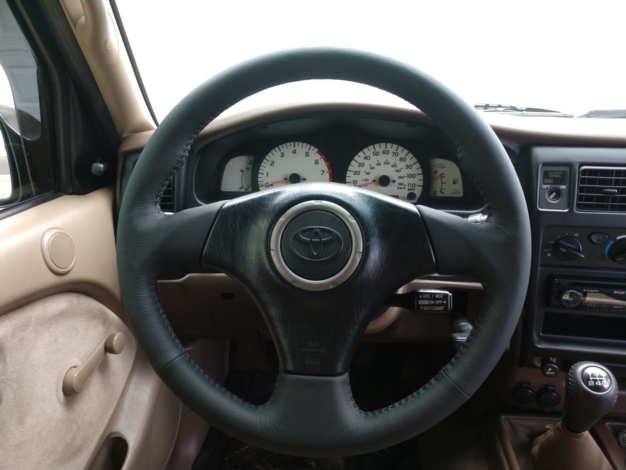

    All of em to my knowledge use the same size splined shaft and nut. Airbags are tricky though. I know one out of a 2002ish Rav4/Is300 works in the 01-04 Tacomas. Heres my Rav4 wheel I had upholstered.

    Loving that wheel; had to tag you because of it.

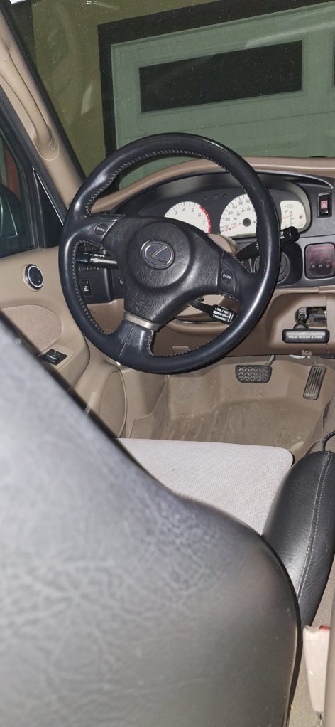

    Nah - just horn, airbag and cruise functions.

    Where did you have the reupholster done?
  18. May 30, 2025 at 9:36 AM
    #18
    Blue92
    Blue92 Well-Known Member
    Aug 26, 2017
    #228071
    16,481
    Daniel
    North Carolina
    2018 Sport
    Craft Customs in Texas
