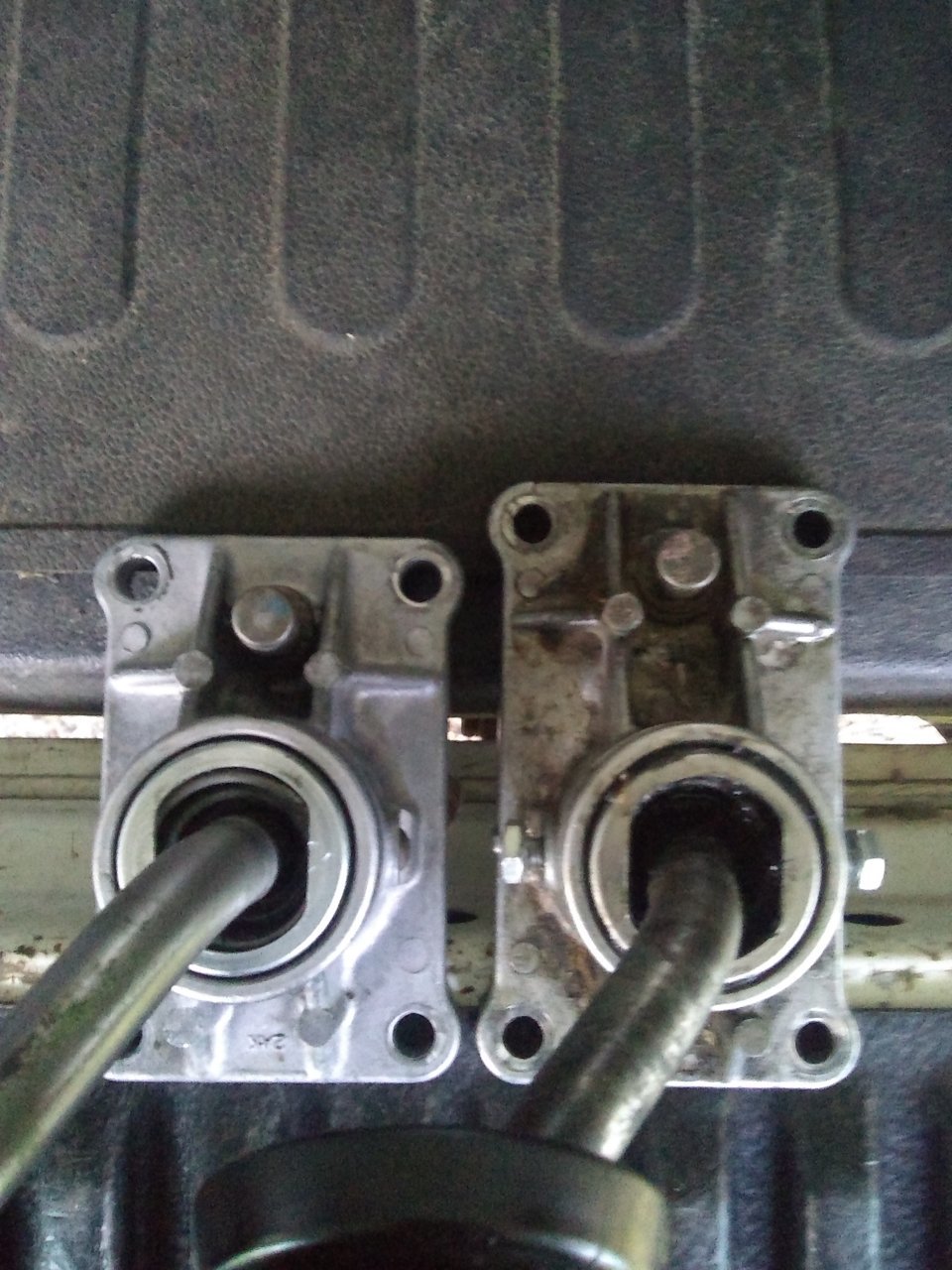

    Hello, brand new here and stumped as to which tranny is in my 98 Tacoma.
    It is not the W59 it's supposed to be, and it's not an r150 as the shifter on the left is close, but no cigar...
    Look at this photo and please ID my transmission!!! I have about gone blind trying to figure it out...
    My shifter on the right, R150 on the left...
    Thank y'all in advance!

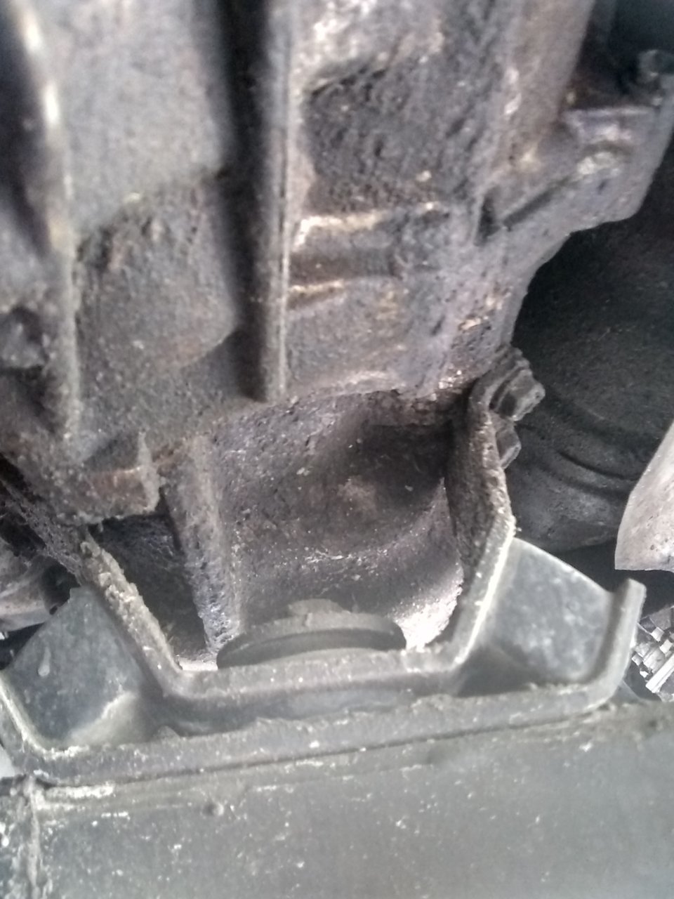

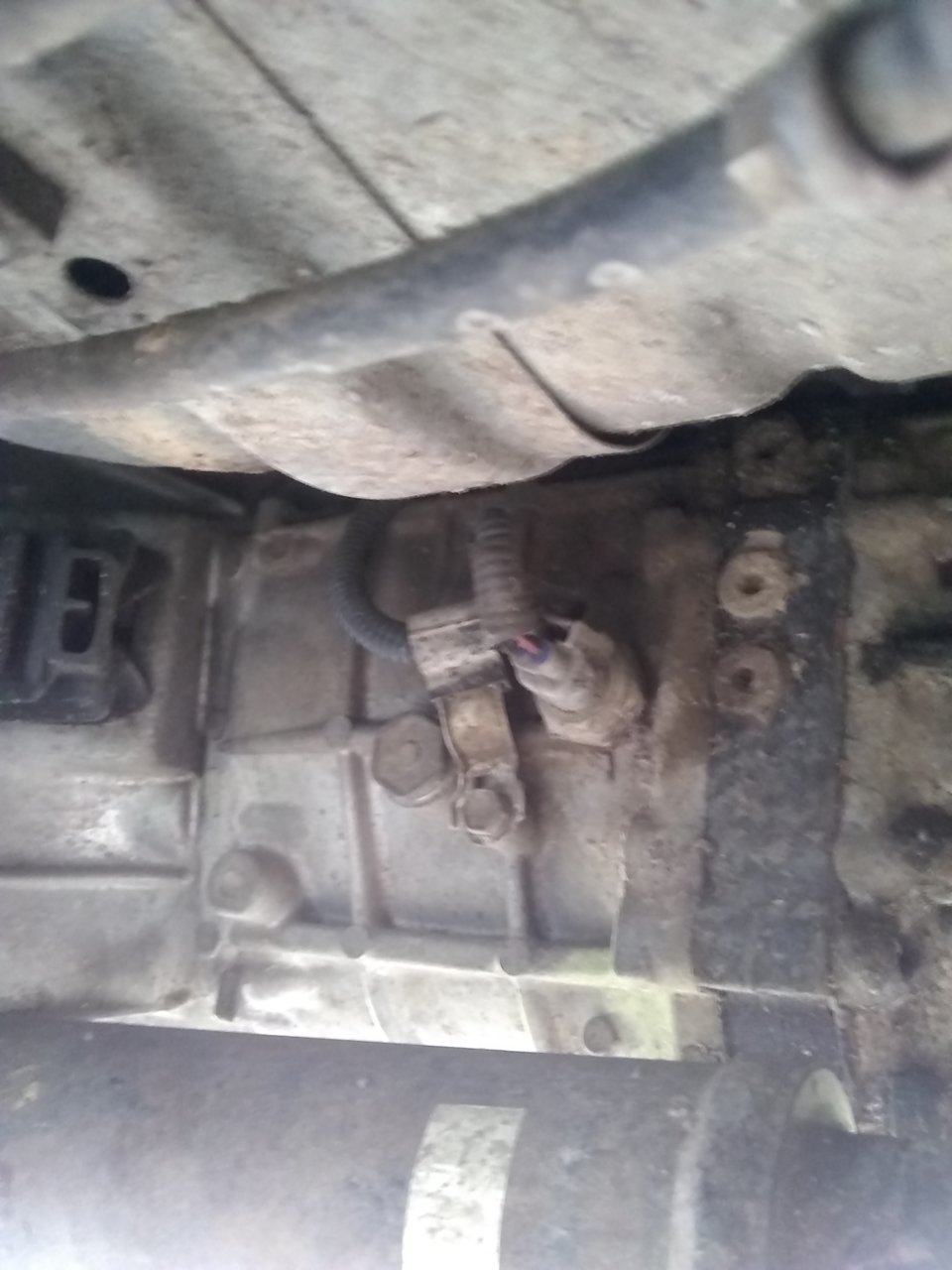

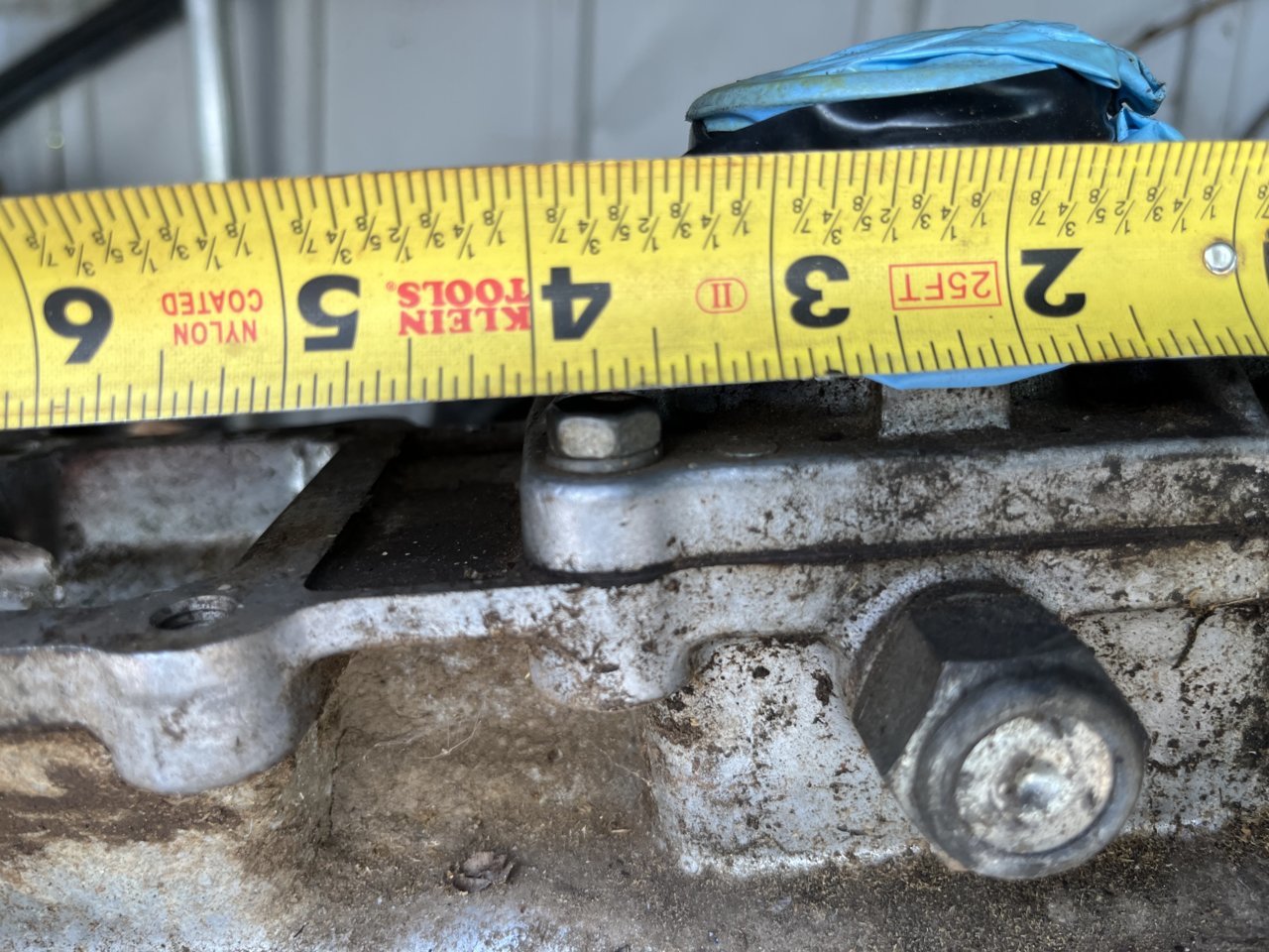

    Here's some photos, terrible I know...
    IMG_20220522_123310516.jpg IMG_20220522_123419168_HDR.jpg IMG_20220522_123436008_HDR.jpg IMG_20220522_123310516.jpg
    I was hoping someone would just recognize the difference in the shifters and know...
    I've about gone blind trying to figure it out, with no results.

    At this point, I am not sure of anything.
    Engine is a 2.7
    The shifter on the left was ordered off eBay from a guy that seems to know his stuff.
    The shifter in my trans is broken, but bush fixed, and I need to source a housing that matches mine.
    All the rest of the parts interchange.
    I didn't know I was getting into a Frankentruck, but here I am...
  7. May 22, 2022 at 9:54 AM

    It appears to be a w59 to me. Did you mistakenly order a shifter for a two-wheel drive w59 when you need a four wheel drive? The shifter turrets are different between the two wheel drive and four-wheel drive versions

    A w56 will bolt to a w59 bellhousing which will obviously bolt to a 2rz/3rz. But thats doesnt look to be the issue here. I have 3 r150fs, both early, late, and taco and there is a mix of shifter bases depending if it was behind a 3.0 or a 3.4 and if it was in a t100 or pickup or taco. But it would take a custom bell housing to bolt that up to your 3rz anyways unless you have a unicorn r151 bell.

    If it helps anything, the R150f shifter on the left is 4-1/2" spacing on the long side, and whatever mine is measures 4-7/8"...
    I am amazed that I can't find the answer to this. I've been diggin' for two days. Worst parts problem I have ever run into as far as a "what the heck is it" goes...
    One of the studs broke on my old shifter, and the stick rotated. As of now the housing holes have been tapped, and bolts and lock washers are holding it all together and it works fine.
    But I know this bush fix ain't gonna last forever, and I am going to have to figure this out...
    I gotta be missing something simple, there just can't be that many possibilities, can there???

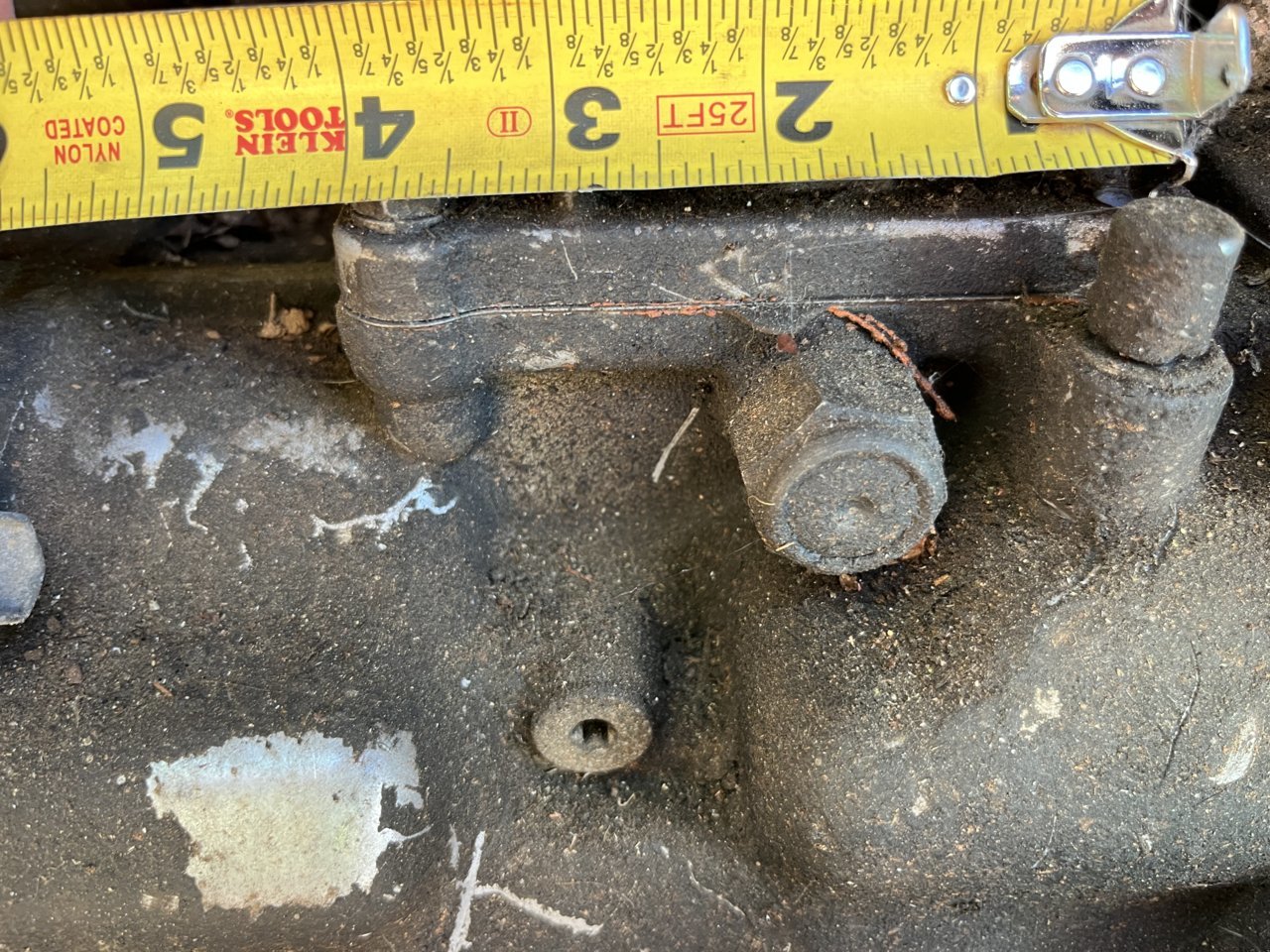

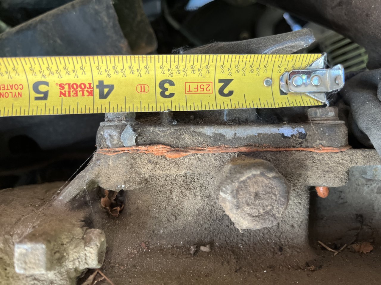

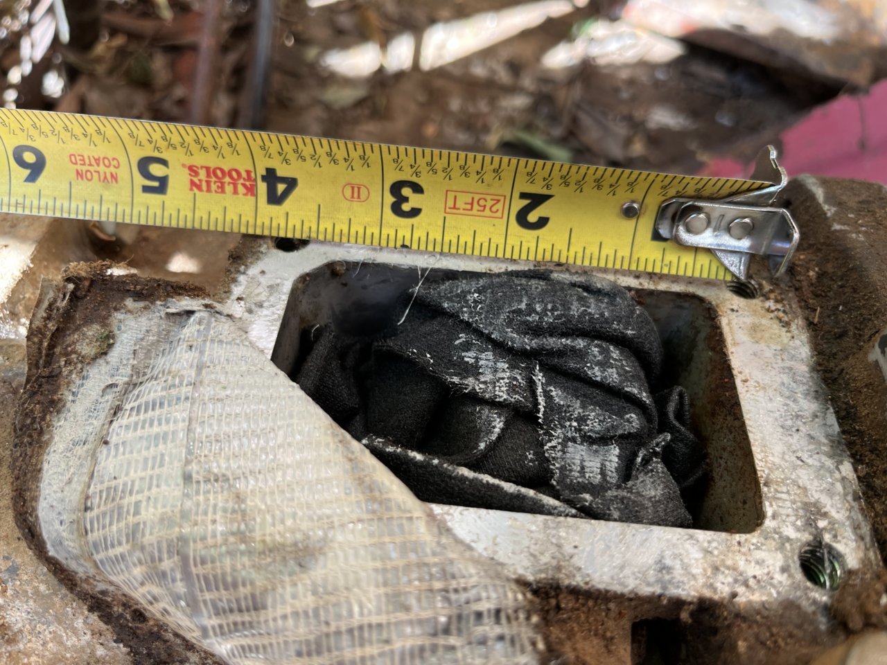

    I just walked out to my pile and took some pics.
    R150f from 3.0 t100
    W56 early, so prior to 89
    W56 late 89+
    R150f from 98 4runner
    Railroader1[OP] likes this.

    I saw that one..
    And thanks for the photos. There's a few that ain't what I have...
    'preciate ya PPF!

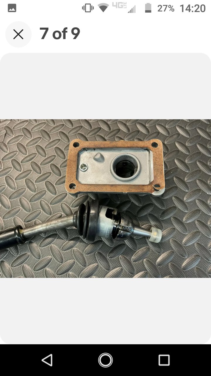

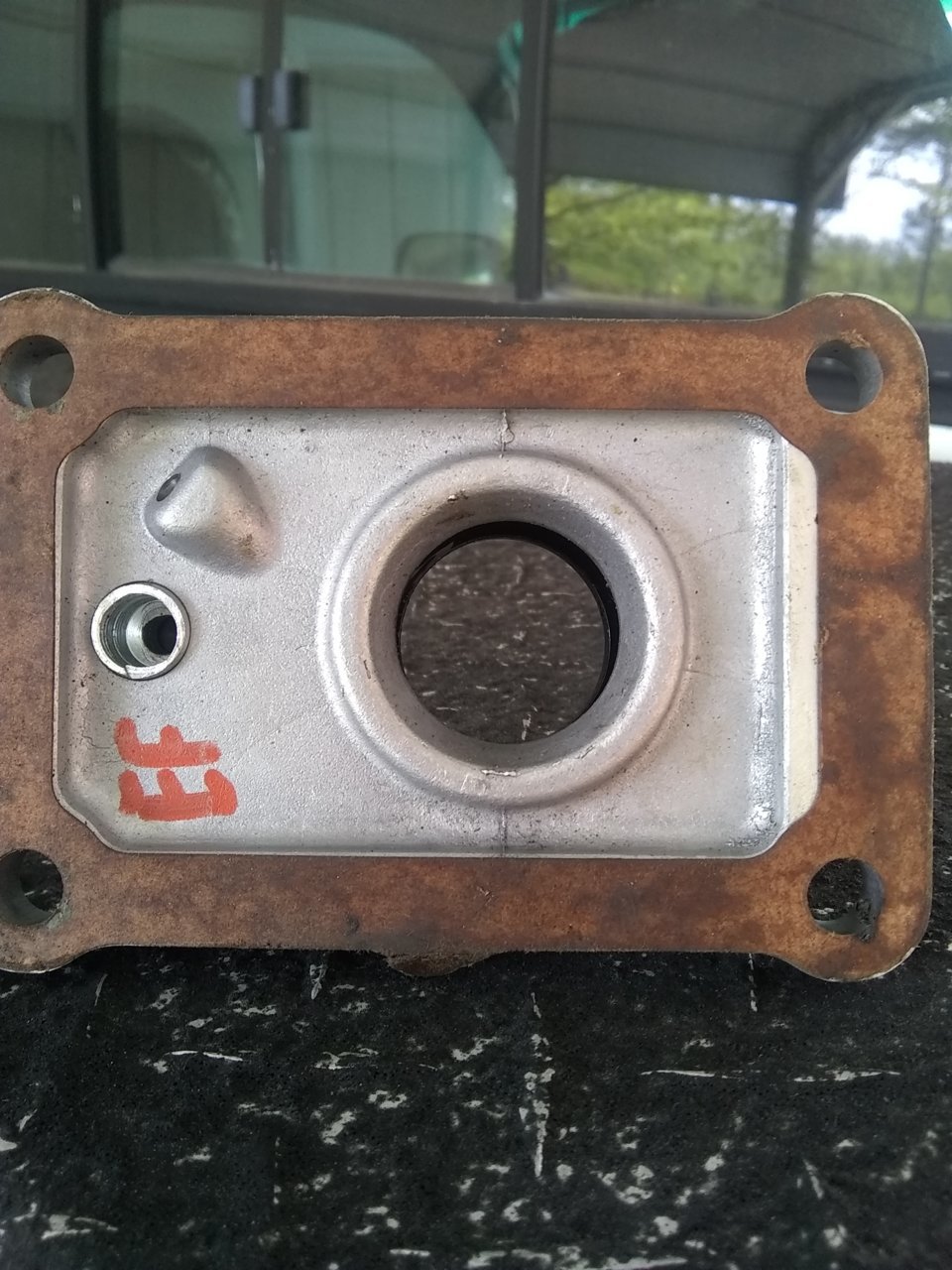

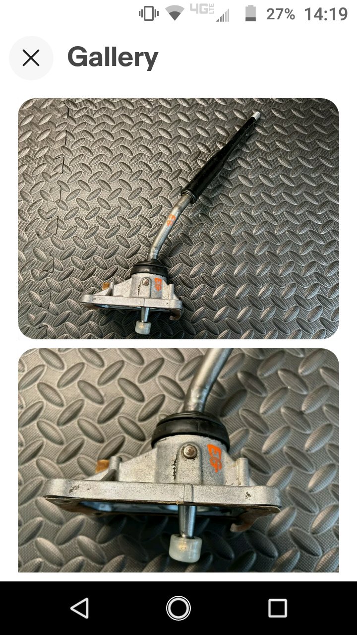

    Well, I got back in contact with eBay guy, and he says this came out of a W59f...Says the W59 is six bolts, but the F is four.
    Screenshot_20220522-141944.jpgScreenshot_20220522-141944.jpgScreenshot_20220522-142044.jpg
    This LOOKS long enough to me, but of course he doesn't have another one...
    A dealer parts monkey may have sent me on a wild goose chase, and I have a W59f all along...
    Thanks for y'all's help, and I will update! Done worrying about this for today...
    #19
    Bivouac likes this.
  20. May 22, 2022 at 11:54 AM
    #20
    Railroader1
    Railroader1 [OP] Member
    May 22, 2022
    #397724
    12
    Compare pic 7 of 9 to this, and I believe my problem is solved...
