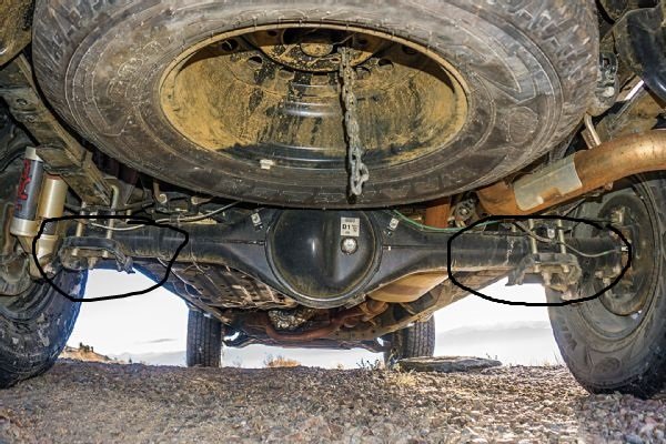

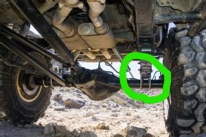

    Without Ubolt flip kit

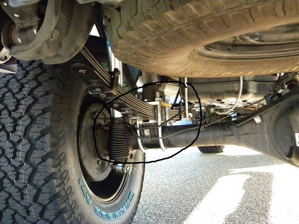

    With ubolt Flip Kit

    So if you look under your truck the U-bolts go around the springs and the plate is on the underneath of the axle and the ends of the U-bolts hang down. You loose some ground clearance with this design as well could damage the ends of the u-bolts by hitting them when offroading. The U-bolt flip reverses this and the U-bolts wrap around the axle and the plate is on top of the springs. This gains the ground clearance and eliminates damage to the plates and ends of the u-bolts.

    Exactly here is a pic of both to compare.
